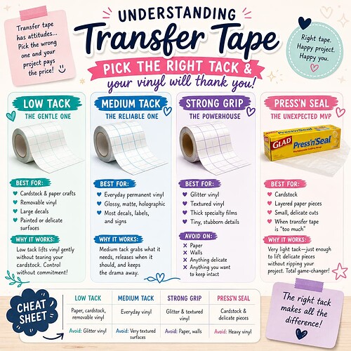

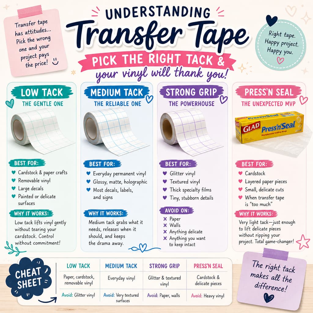

Understanding Transfer Tape Tack Levels (and Why They Act Like Moody Houseplants)
You ever notice how transfer tape has attitudes?
Low tack is chill. Medium tack is the reliable friend. Strong grip is that cousin who hugs too hard at family reunions. And then there’s Press’n Seal… the chaotic good hero none of us expected.
Let’s break down what each one is actually good for so your vinyl stops fighting for its life.
🩵 Low Tack Transfer Tape
Best for:
  • Cardstock & paper crafts
  • Removable vinyl
  • Large decals
  • Painted or delicate surfaces
Why it works:
Low tack is the gentle soul of the transfer‑tape world. It lifts vinyl without ripping your cardstock into confetti. Perfect when you need control without commitment.
Selizo Low Tack Transfer Tape: Amazon.com: selizo 20 Pack Clear Transfer Tape, Contact Paper Decal Transfer Sheet Low Tack Ease Paper Transfer Tape for Craft : Arts, Crafts & Sewing
:blue_heart: Medium Tack Transfer Tape
Best for:
  • Everyday permanent vinyl
  • Glossy, matte, holographic
  • Most decals, labels, and signs
Why it works:
Medium tack is the “default setting” of transfer tape. It grabs what it needs to grab, lets go when it’s supposed to, and doesn’t cause drama. If transfer tape were a coworker, this would be the dependable one who actually reads the emails.
HTVRONT Medium Tack Transfer Tape: Amazon.com: HTVRONT Transfer Tape for Vinyl - 12" x 10 FT w/Red Alignment Grid Clear Transfer Paper for Adhesive Vinyl - Medium Tack Vinyl Transfer Tape for Decals Signs Windows Stickers
:purple_heart: Strong Grip / High Tack Transfer Tape
Best for:
  • Glitter vinyl
  • Textured vinyl
  • Thick specialty films
  • Tiny, stubborn details
Why it works:
Strong grip is the heavyweight champion. It’s the only thing that can convince glitter vinyl to get up off the mat. But use it on cardstock and it will take the cardstock with it like a souvenir.
Avoid on:
  • Paper
  • Walls
  • Anything delicate
  • Anything you want to keep intact
HTVRONT Strong Grip Transfer Tape: Amazon.com: HTVRONT Transfer Tape for Vinyl - 12" x 10FT Black Alignment Grid Clear Transfer Tape for Shimmer Adhesive Vinyl Transfer Paper for Signs Stickers Decals Walls Doors
:white_heart: Press’n Seal — The Unexpected MVP
Best for:
  • Cardstock
  • Layered paper pieces
  • Small, delicate cuts
  • Situations where real transfer tape is “too much”
Why it works:
Press’n Seal has a very light tack — just enough to lift cardstock pieces without tearing them. It’s perfect when you’re transferring tiny leaves, flowers, or lettering and don’t want to risk ripping your project.
It’s basically the “I got you, girl” of the craft room.
Glad Press N Seal: Amazon.com: Glad Press'N Seal Food Plastic Wrap, 70 Square Foot Roll (Package May Vary)
:dart: Quick Cheat Sheet
Tack Level Best For Avoid On
Low Tack Paper, cardstock, removable vinyl Glitter vinyl
Medium Tack Everyday vinyl Very textured surfaces
Strong Grip Glitter & textured vinyl Paper, walls
Press’n Seal Cardstock & delicate pieces Heavy vinyl
