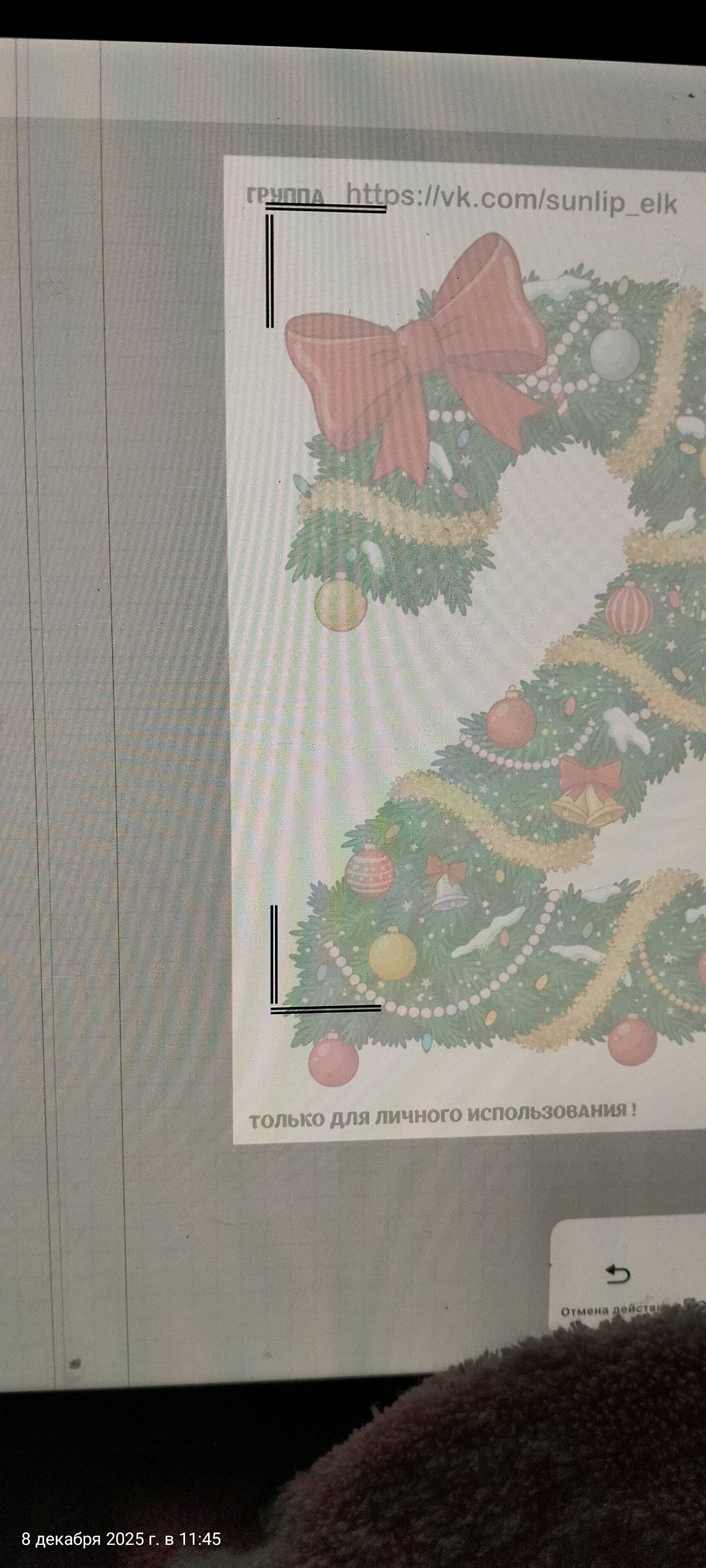

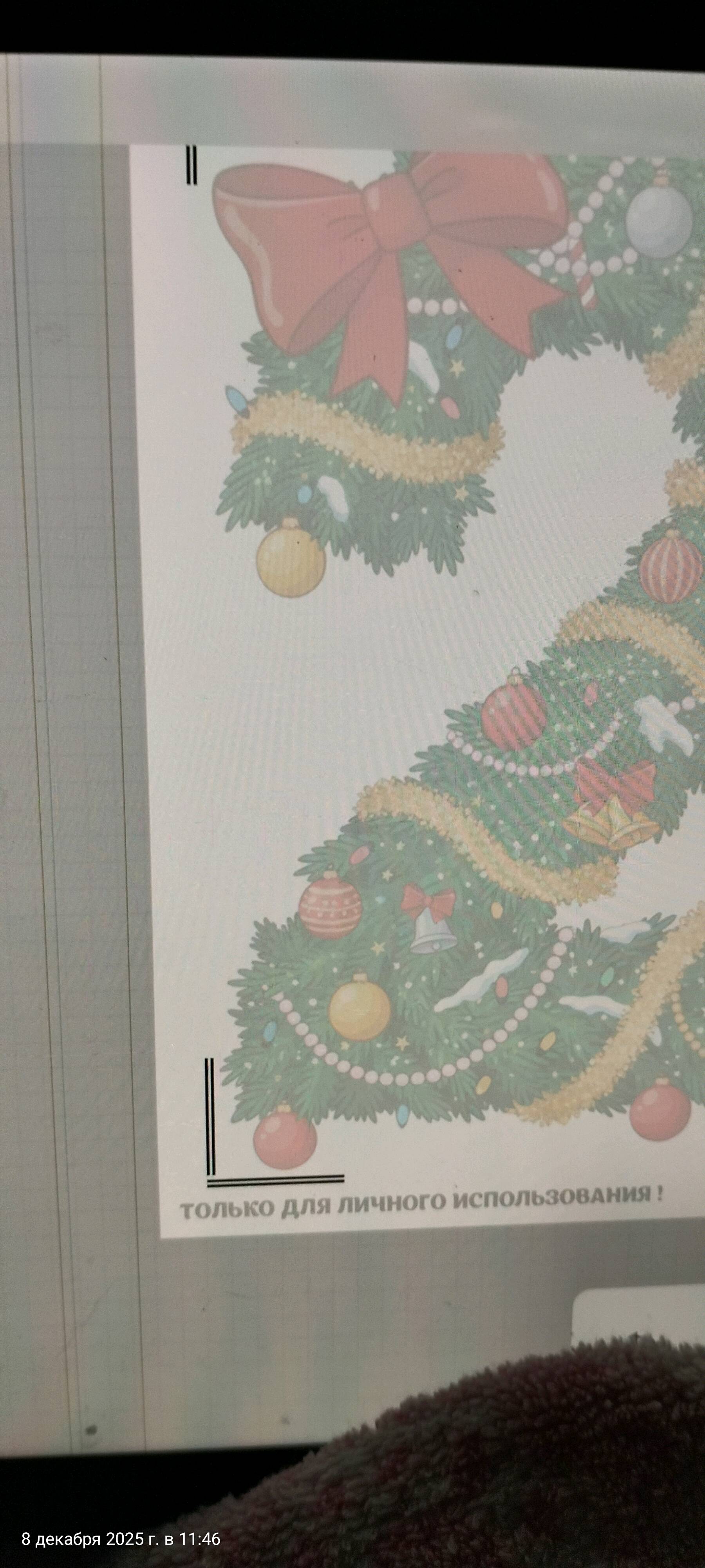

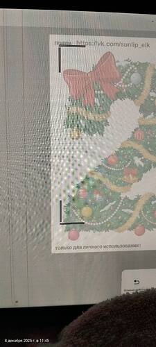

Is it possible to move the labels a little lower, is it possible to adjust them somehow? Thank you in advance :heart::rose::pray:

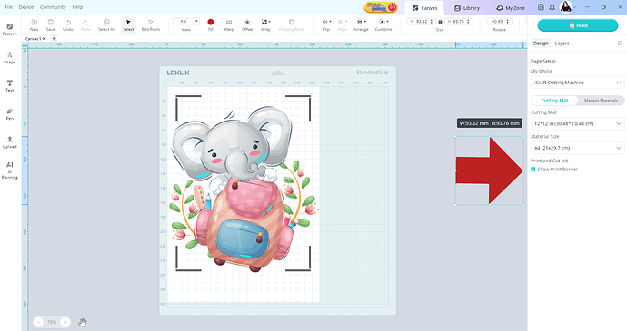

Are you doing a print then cut project or do you just want to print the image out?

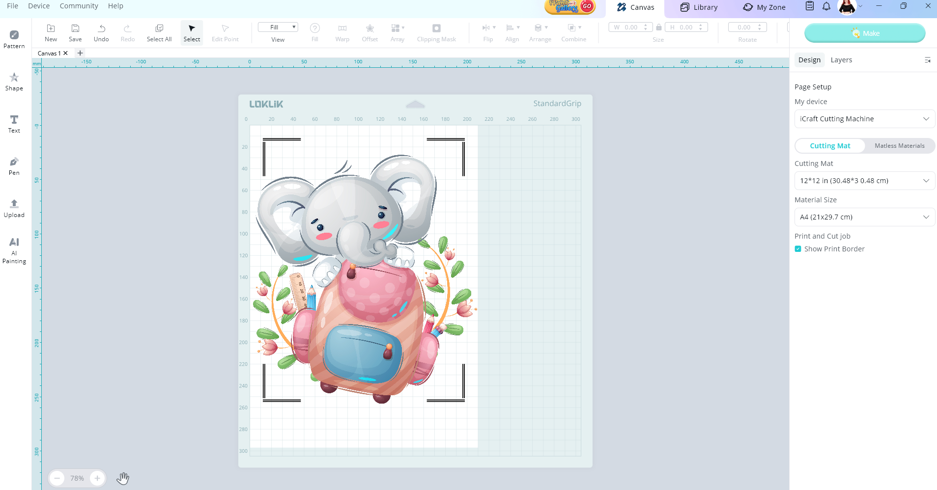

You canโ€™t move the marks in any way but you can move your image up and down and left and right to make it fit within the marks. You do have some room on the bottom that is usable. You can add your paper size in the design tab under material size

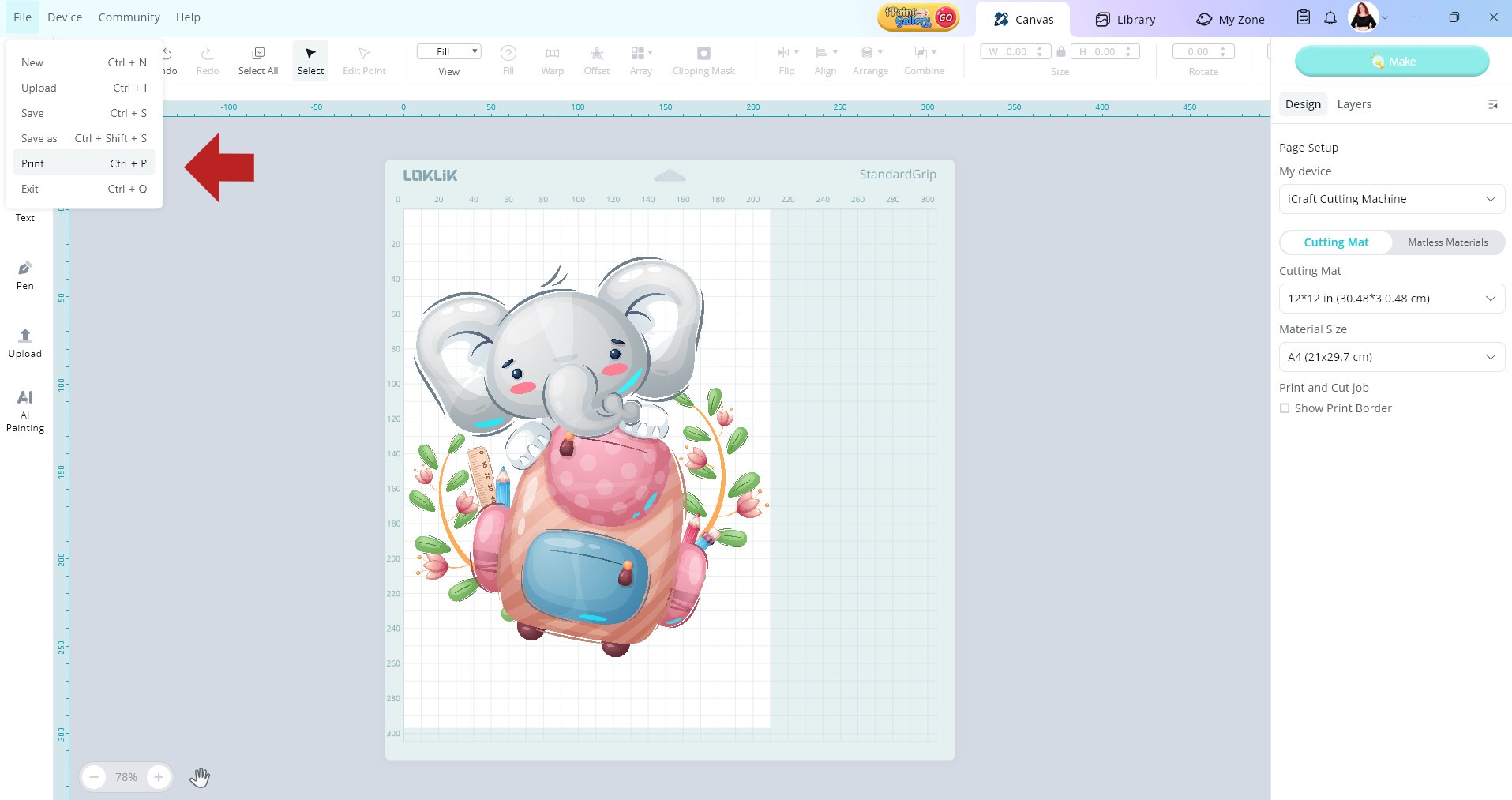

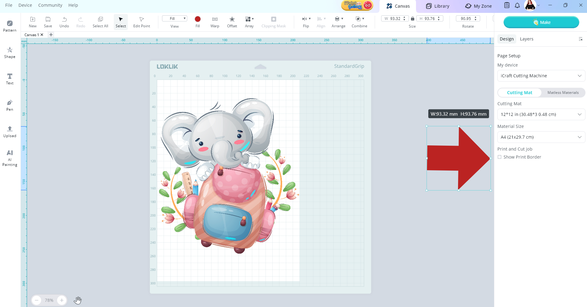

If you donโ€™t need the print then cut function you can turn the print then cut boarders off
Then just print it out.
