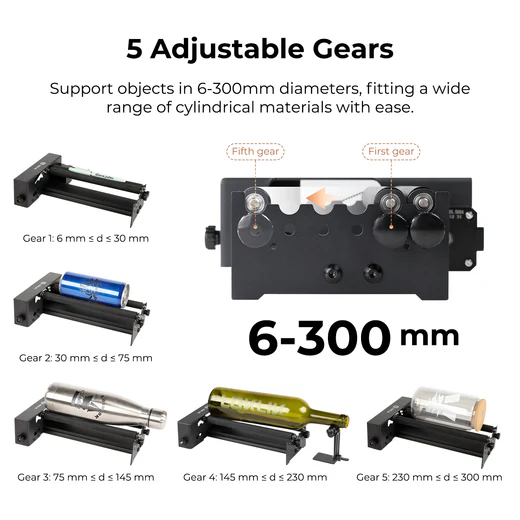

I am engraving a 30 oz stainless steel tumbler, and the tumbler shifts down causing the engraving to go out of line. I was loking to see if HTVRont had stoppers for it, but I was unable to find any. Im up for a suggestion of any kind
Do you have a picture of how you have set it up? Is your steel tumbler too big for the rotary tool setting that you are using? See picture below for a guide
@rinsky might be able to help you better
thank you, I will play with the gear settings, I did move it to 3 since it was 73 mm so maybe I have the incorrect one used. Also, does it matter which way the tumbler is setting meaning top and bottom and which way they are facing ?
Possibly all images I’ve seen are bottom of blank on the gear side
