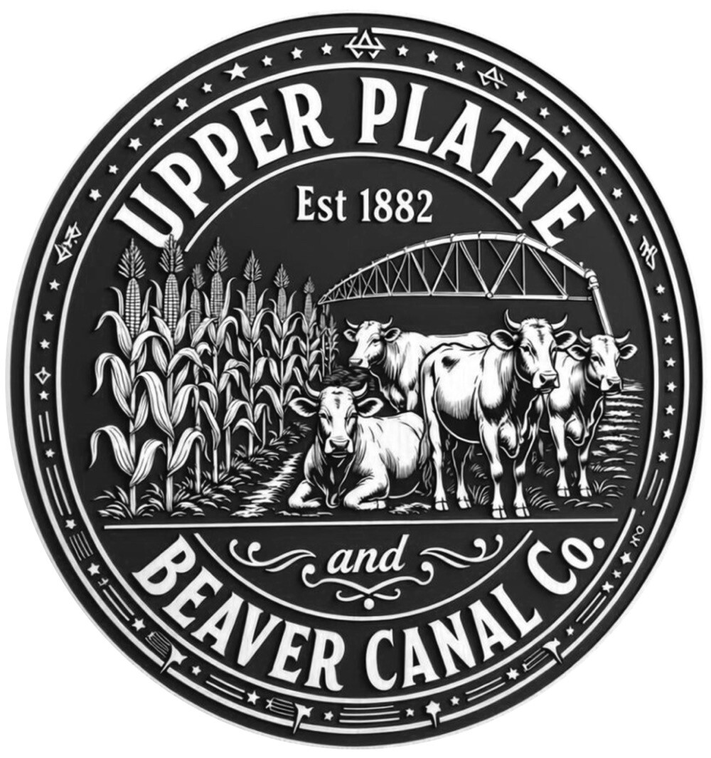

While trying to engrave an image for my husband I came across the word “Stucki” and I am wondering what does it mean? Here is a screen shot I took.
For reference, the image is black and white and saved as a png file. How does this differ from grayscale?

Stucki is an algorithm that simulates shading with dots. Since the iEngrave doesn’t have actual shades of black and white, or other colors, stucki uses a dotting technique to create the gradient that makes an image appear as if it’s been shaded. This will produce a better quality image than the grayscale.
Gotcha! thank you so much for the explanation! I’m going to try that with this image on the clipboard. Will be interesting to see if there’s much of a difference with that and the test I did on a basswood round.
Awesome! Can’t wait to see how it turns out! The image does have some gradient shading on the cows, so it will be a good test for it. :heart:
