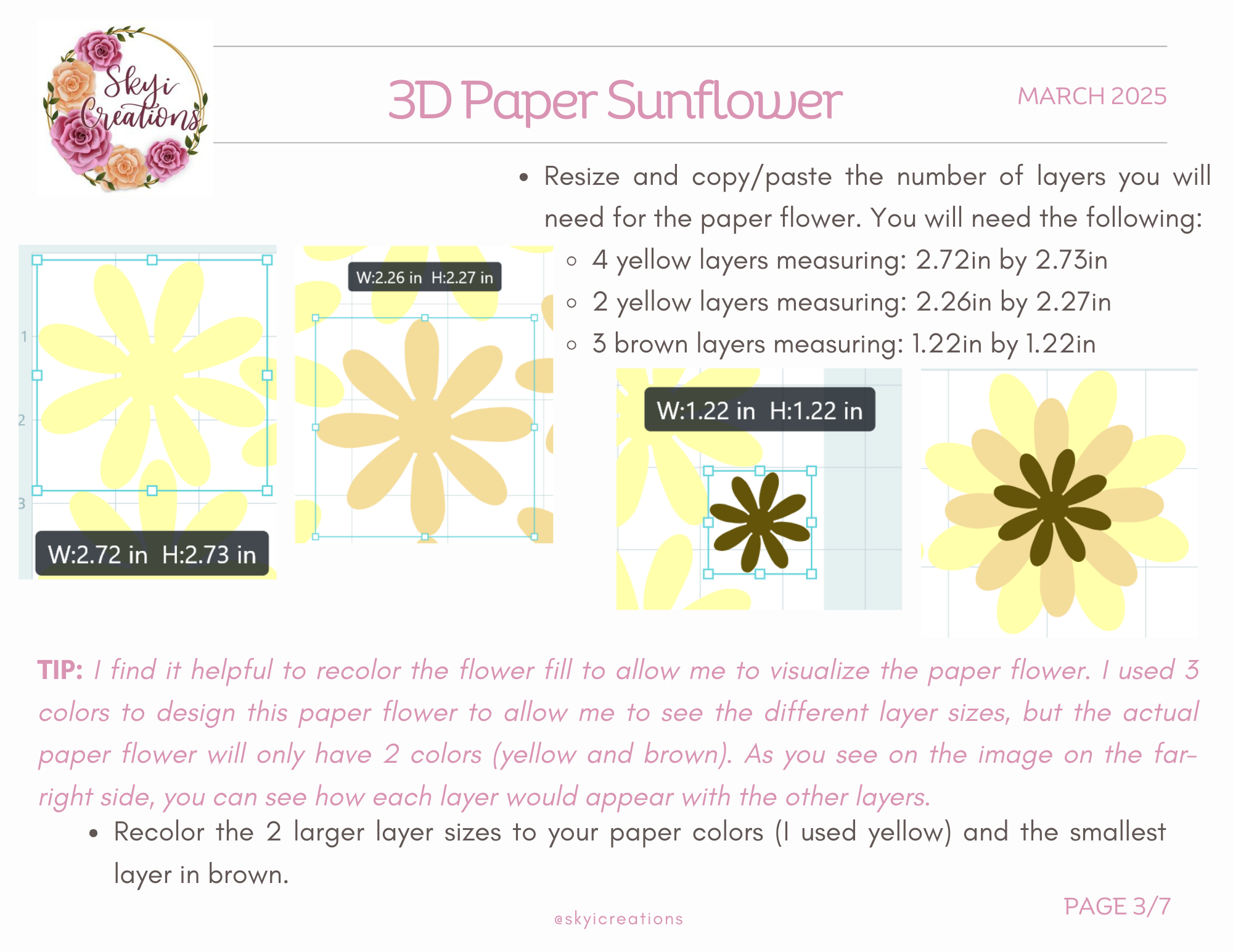

Paper flowers are my favorite :heart_eyes: :two_hearts: the ones on my wooden sign aren’t from the free library but I have done 2 paper flower tutorials that are free in the library. Let me get the links for you.
