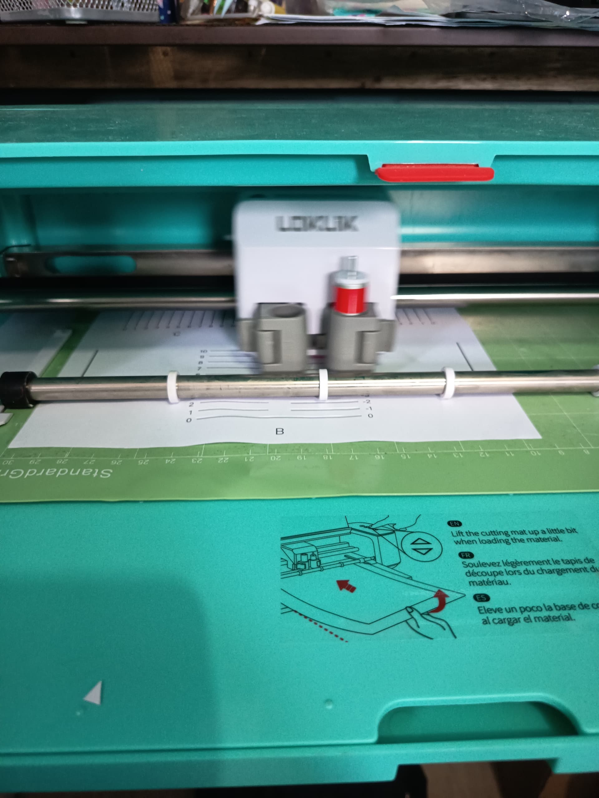

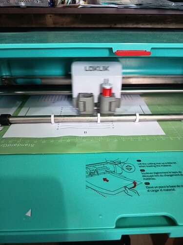

im having issues with my machine not reading the lines to calibrate can anyone help?
it days it cant reaf the lines

Also try aligning the white rollers with the verical lines of the upper registration marks plus one more in the middle of the paper

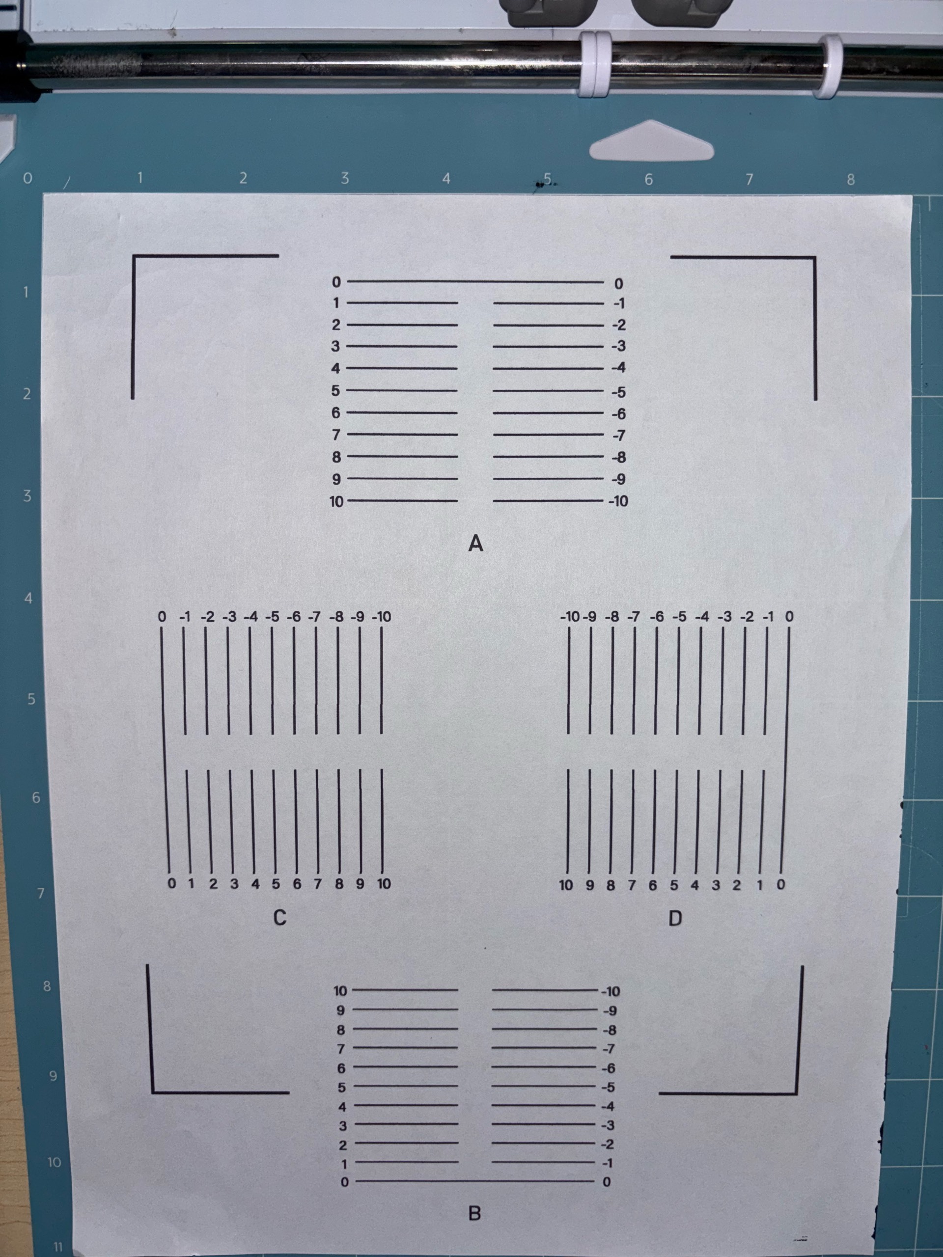

There is a problem with the calibration sheet you printed. It is scaled. Did you print it in the canvas interface? It is recommended that you print in the interface after clicking Make, and set the printer to no scaling.
Maybe it wasn’t reas because there 's a big margin at the sides. Check my other comment, the position of my registration marks are closer to the edge than yours. Maybe it was scaled just like what @Kristin mentioned. If no scaling is available in your printer, maybe you can scale it to 100%

This sheet is not printed 100% scale, it is smaller than that. The margins are too wide. Calibrating with it will only confuse the reader and will result in bad iffset cuttings.
