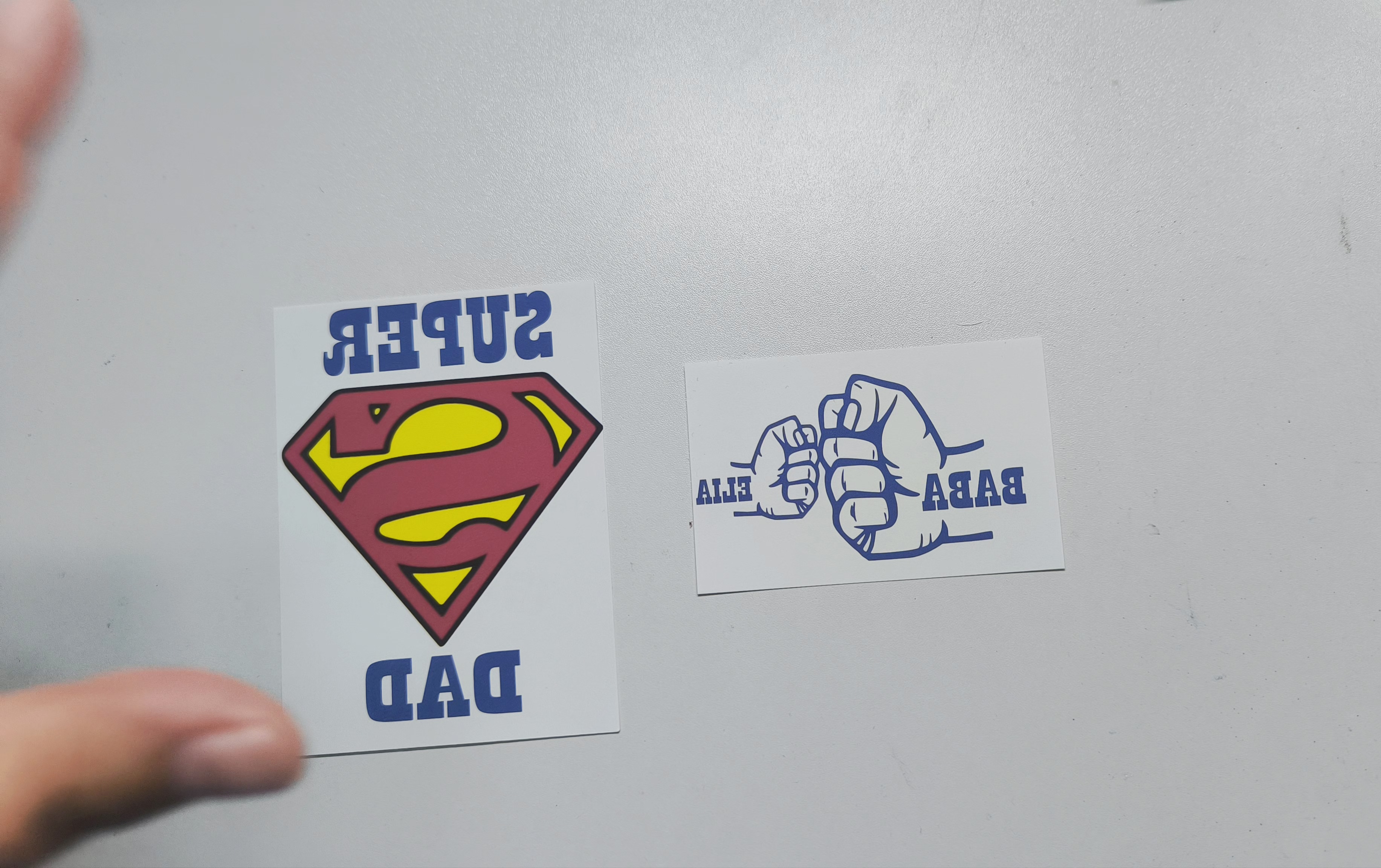

Prepare the design on any design program you like to work with, measure you space on the glass Tumbler, resize the design and then print it.
After printing of course we have to cut the design.

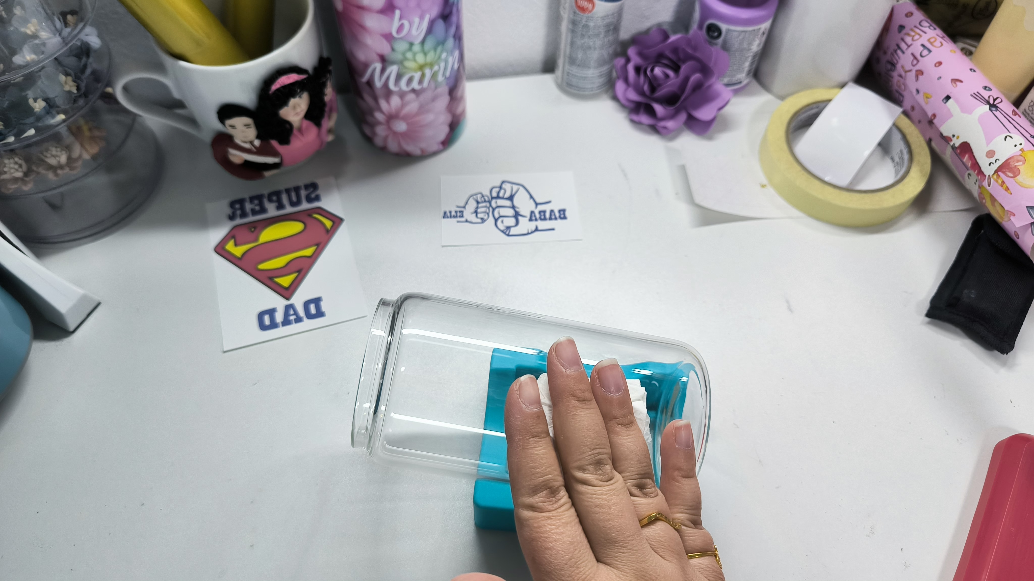

Clean the glass Tumbler with alcohol

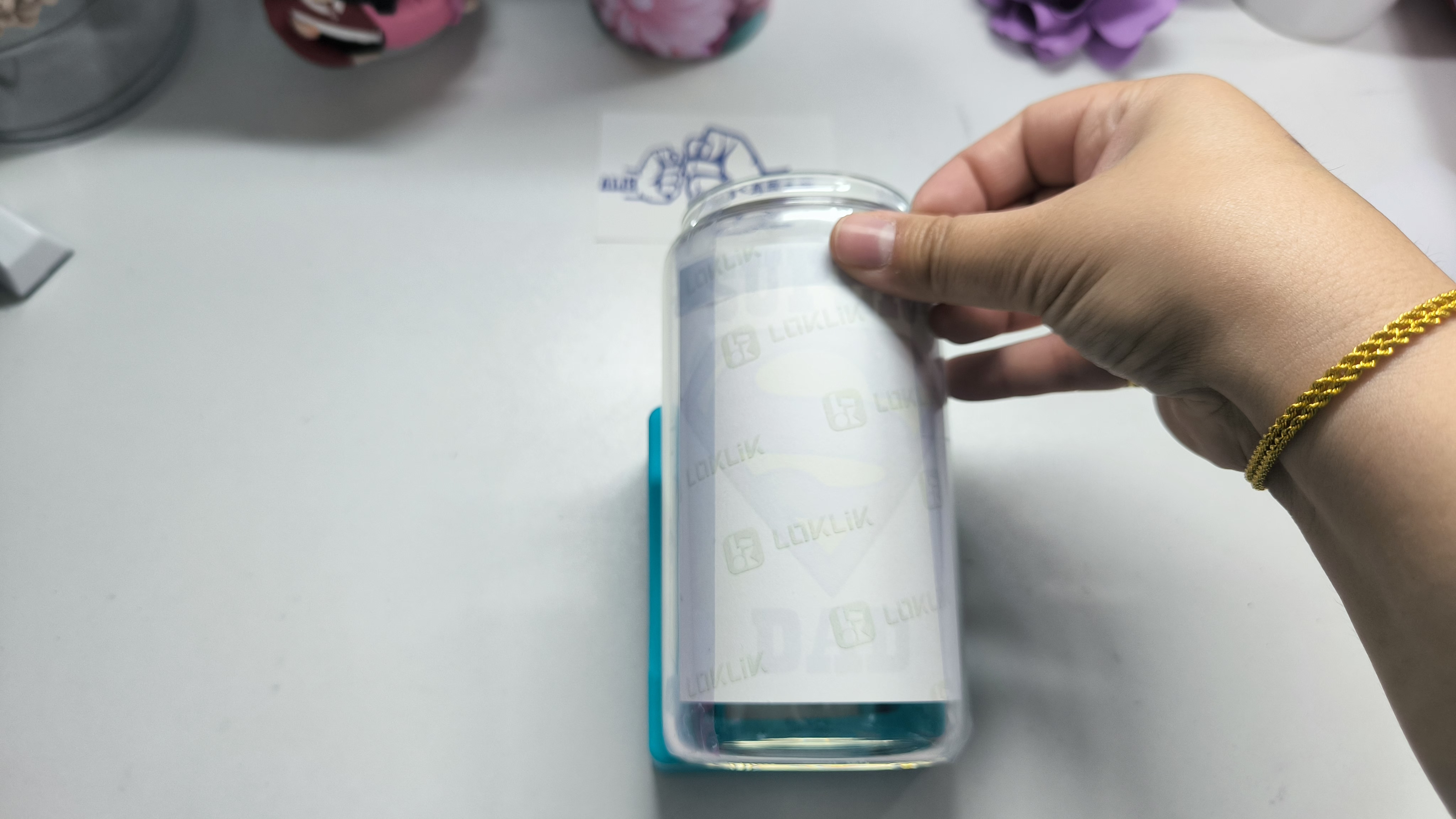

start assembling it on the glass Tumbler and secure it with the heat resistant tape ( I prefare to put the tape on every side of the design)

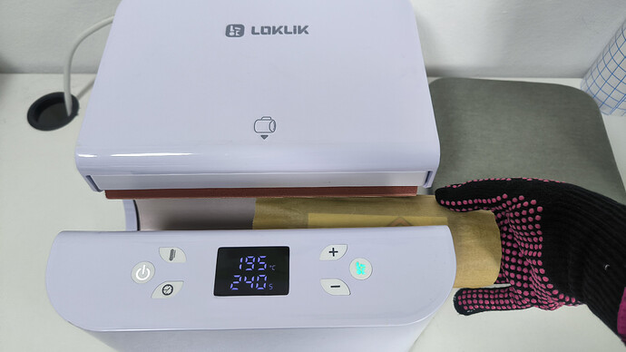

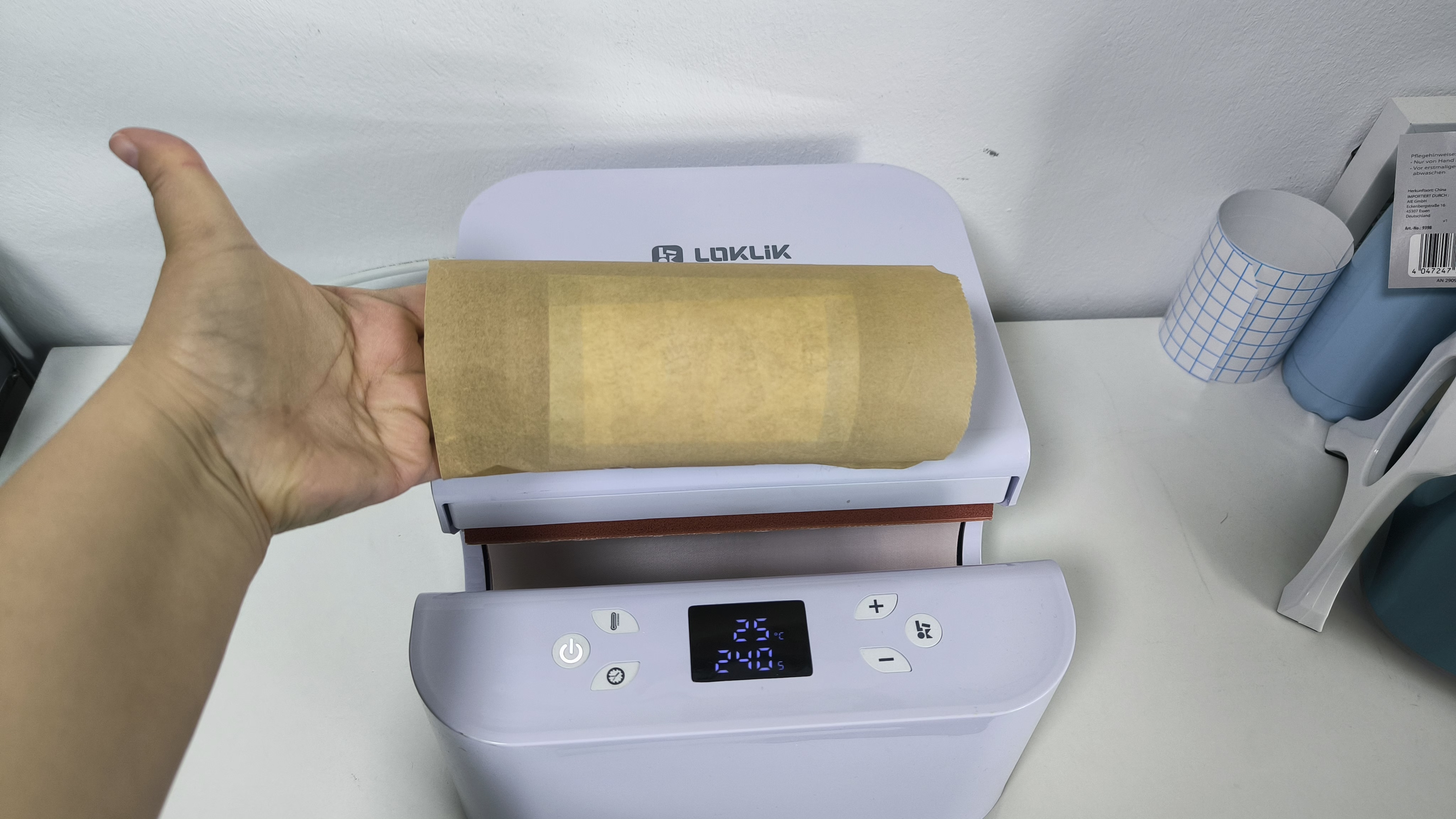

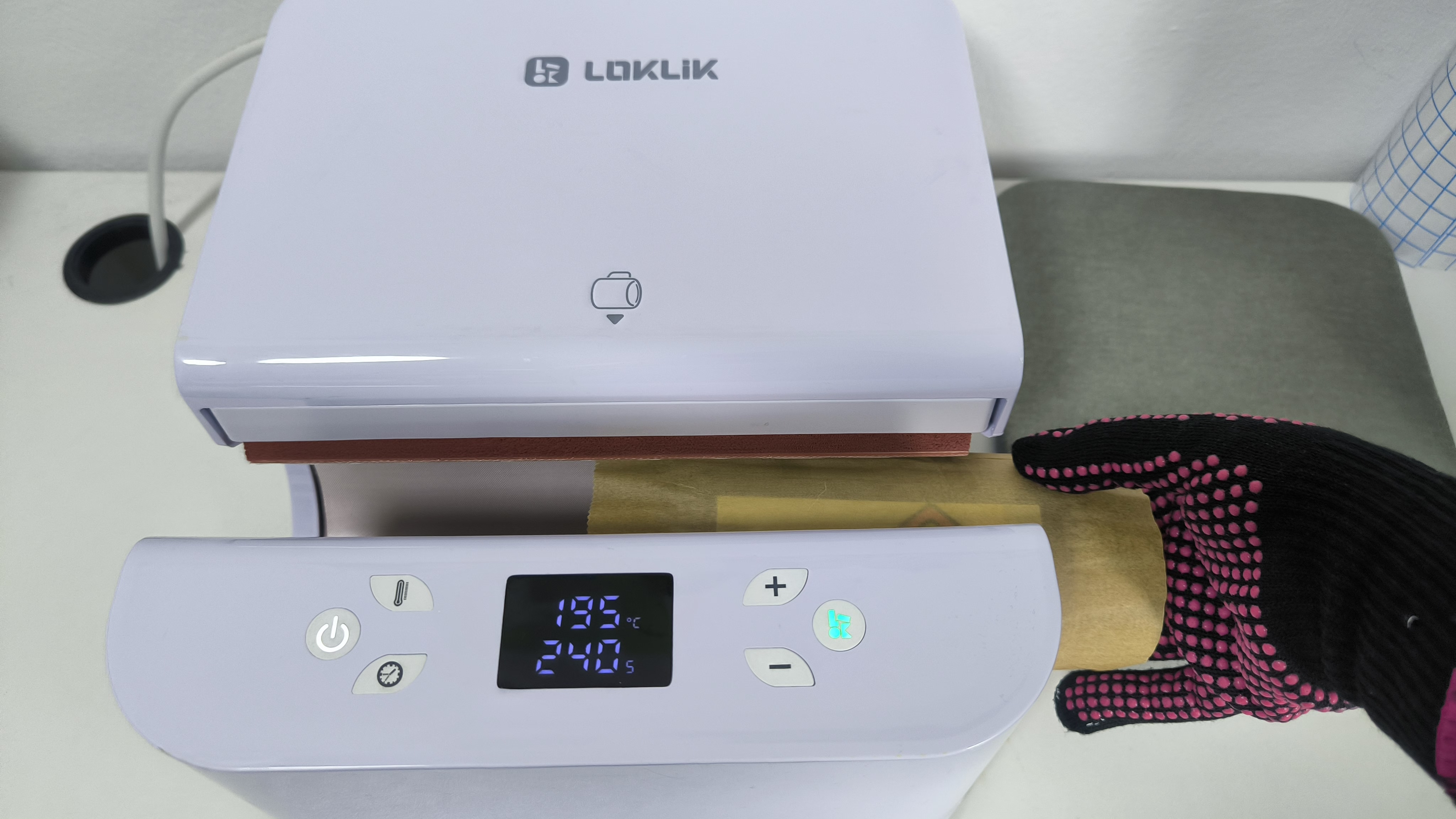

Now because I was working with clear glass Tumbler for the first time i covered it with parchment paper and then turned on the Tumbler press on

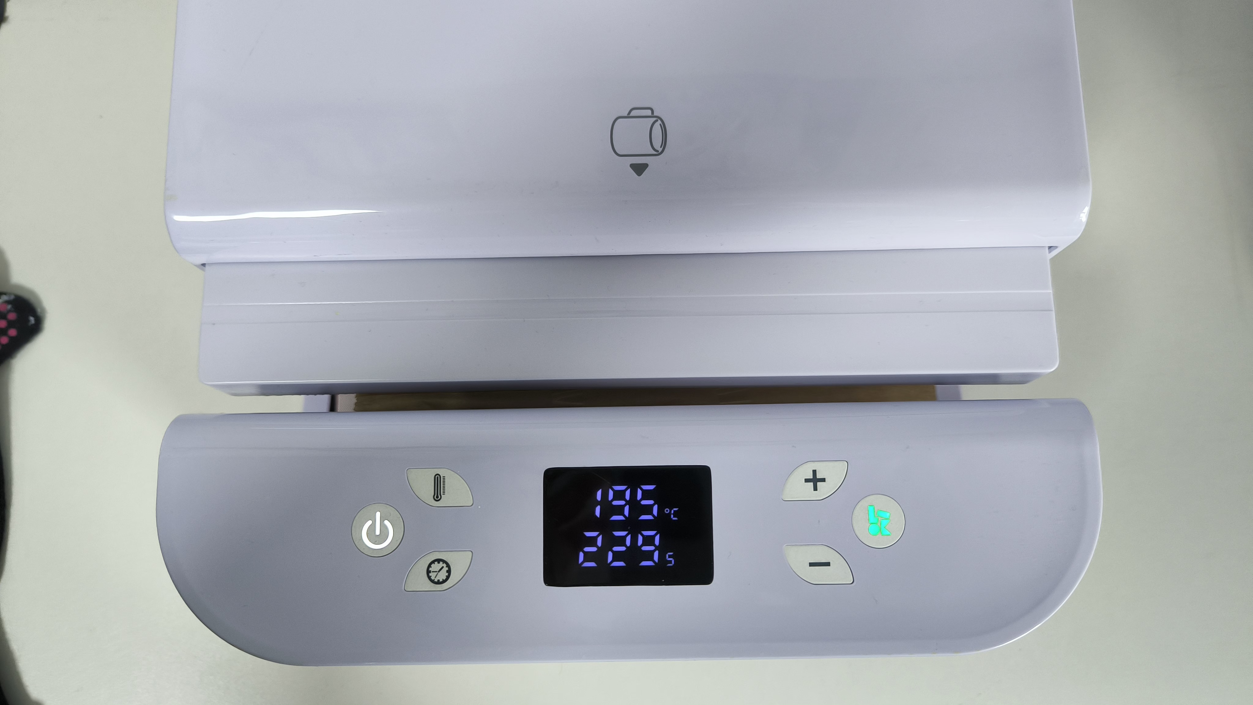

195° for 240 seconds
Slowly and carefully put your glass Tumbler into the Tumbler press once it reaches the correct temperature.
As you will see in the picture the Tumbler press doesn’t close completely on the glass Tumbler…
be careful if you are printing a whole sheet design you ja to rotate it in the middle of the time.

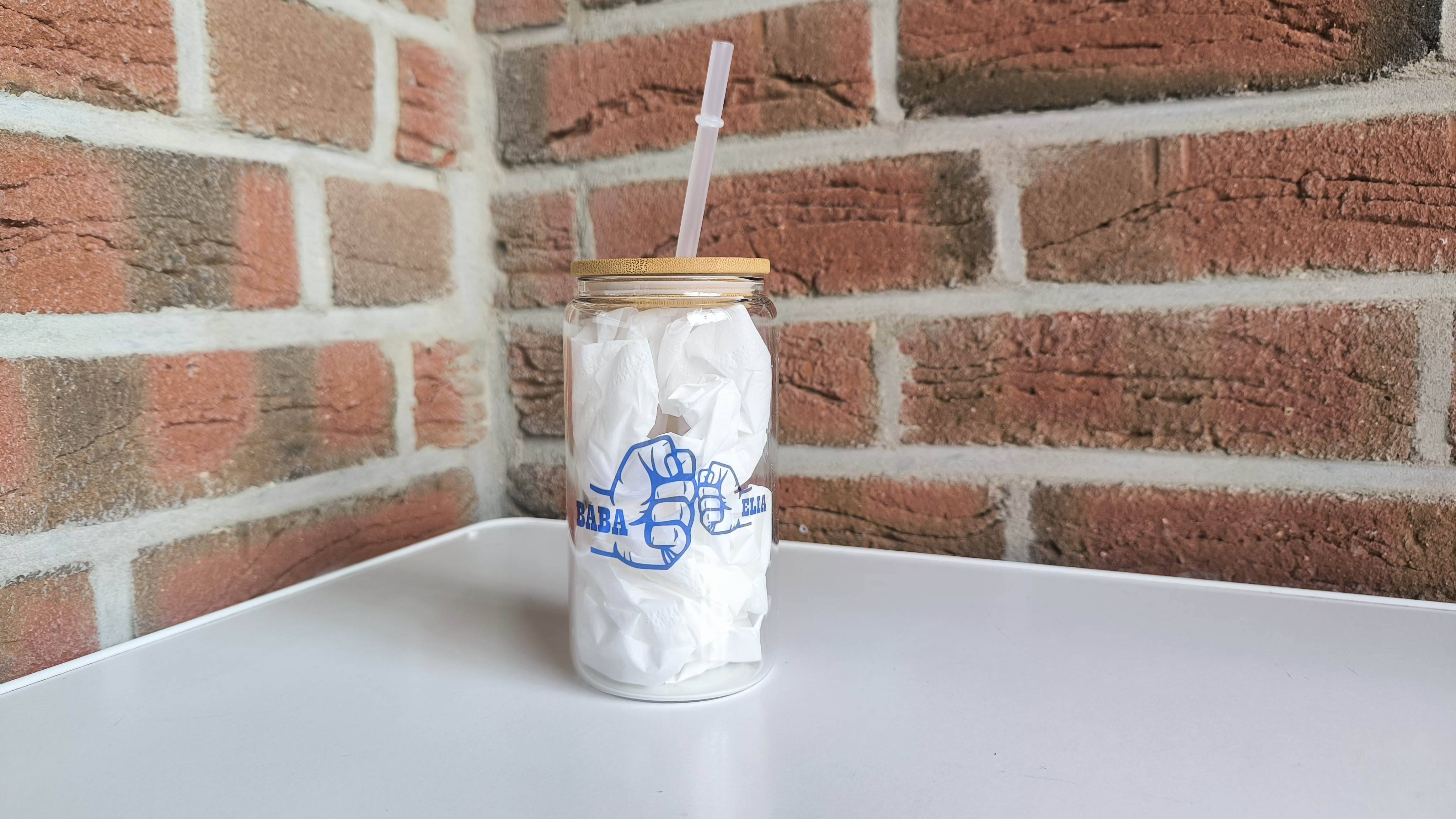

In my case my design was just front and back so I placed the Tumbler to make the side with no design facing up so I didn’t rotate it later.

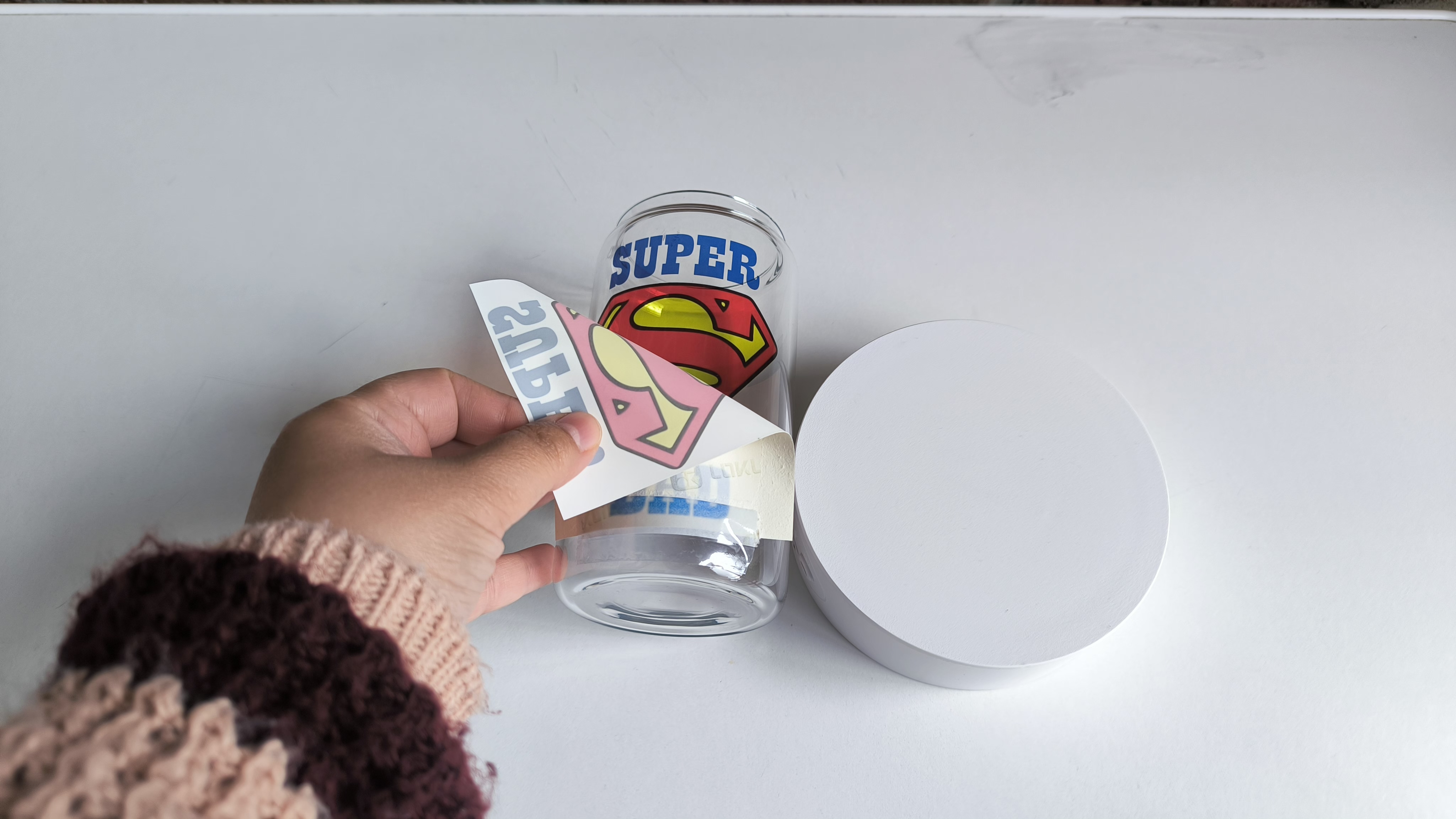

Now that the time is done I let my Tumbler cool completely then started peeling it slowly

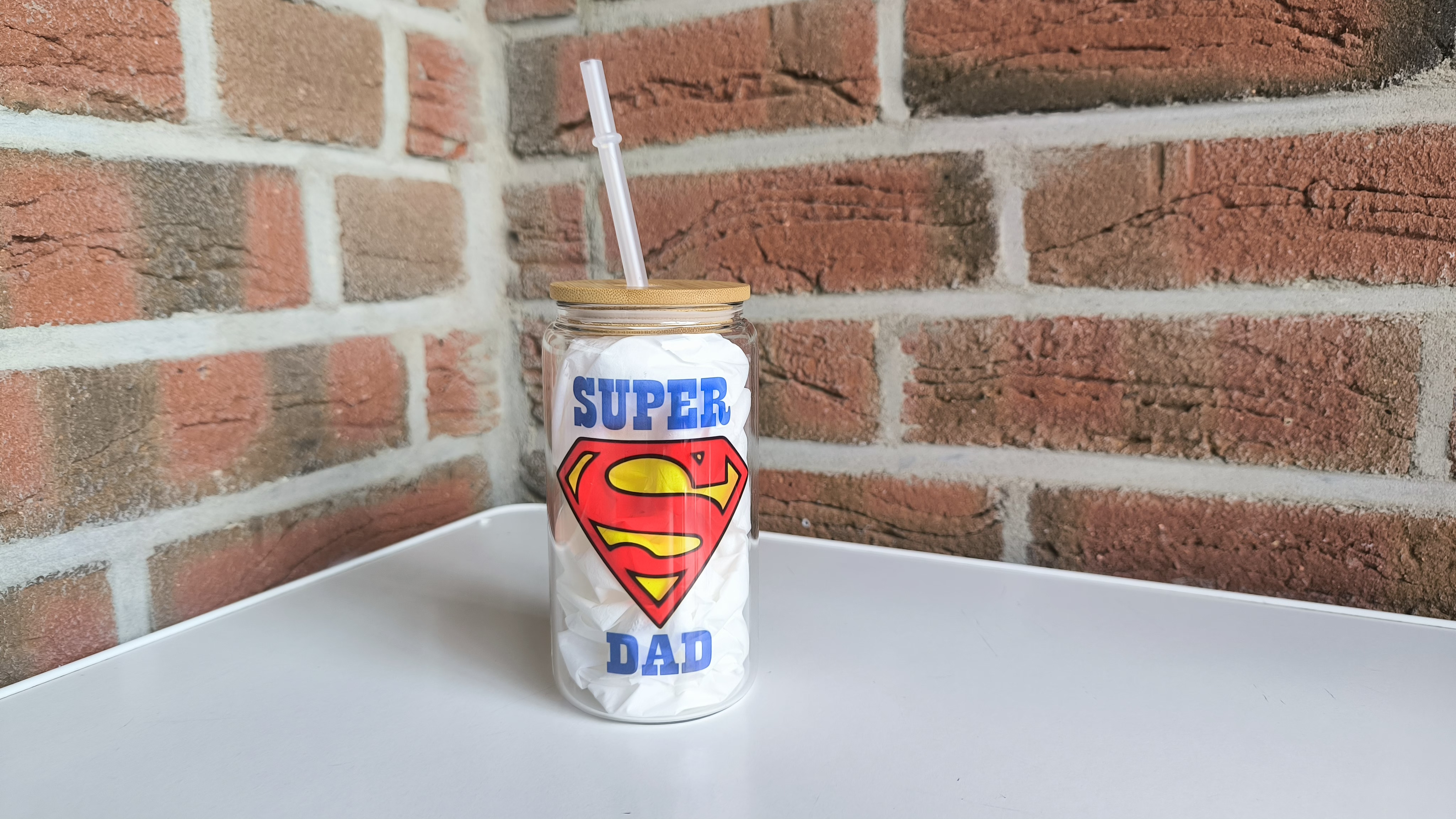

And just like that all my fears ran away as soon as I saw the wonderful results :heart_eyes:
So if you are still thinking of a father’s day gift don’t hesitate to give it a try.

Yes as Belle said they are sublimation Tumblers and there are two types frosty and clear. I was afraid how the pictures will show but eventually they show pretty good when the glass is filled with liquids that have a colour or are dark😊
