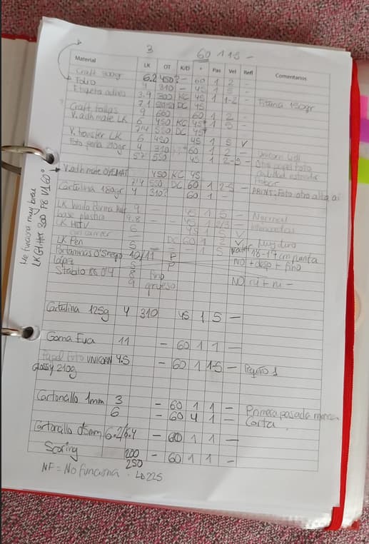

I’d love to get my hands on that ledger too :rofl::rofl: though I might not understand it :rofl:
That’s encrypted :joy:

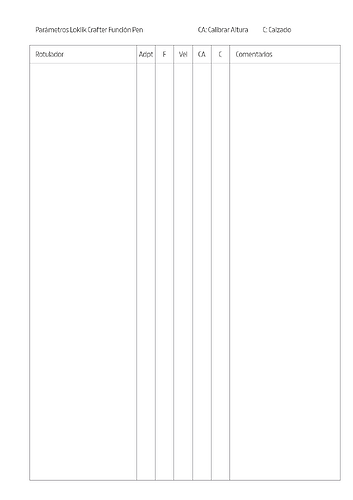

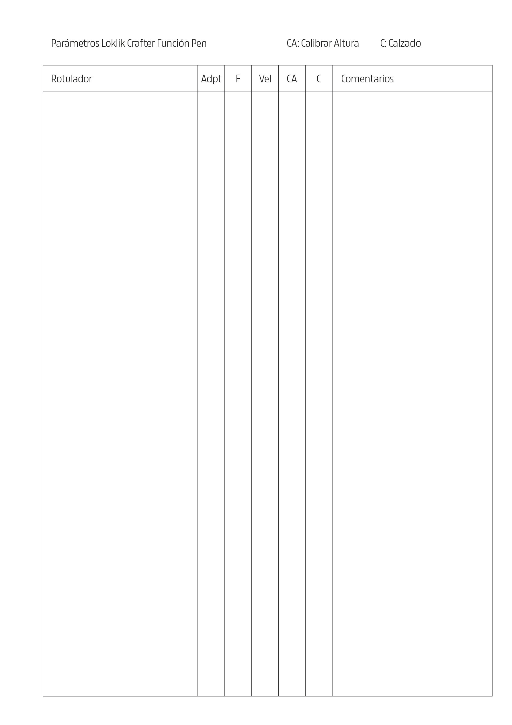

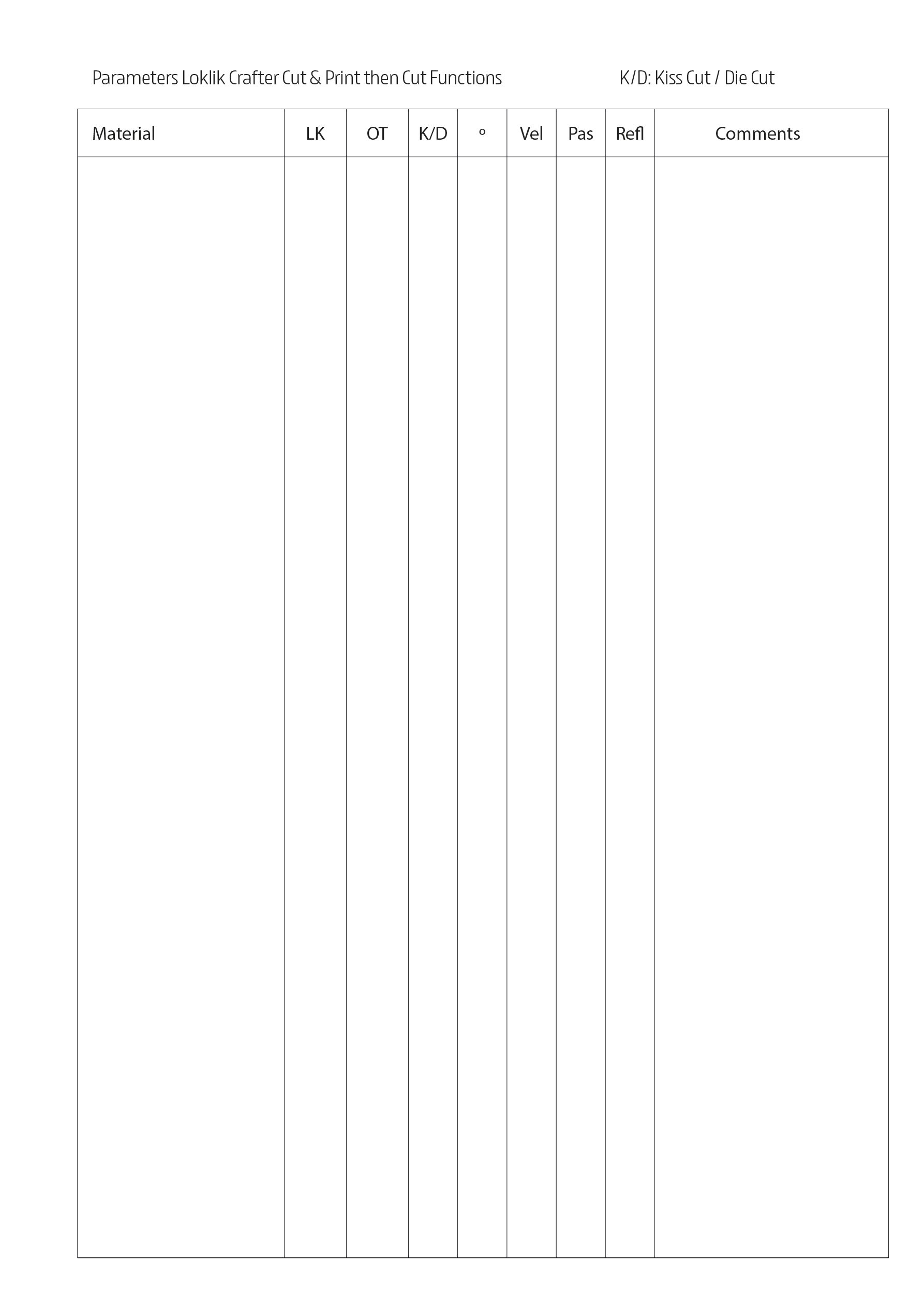

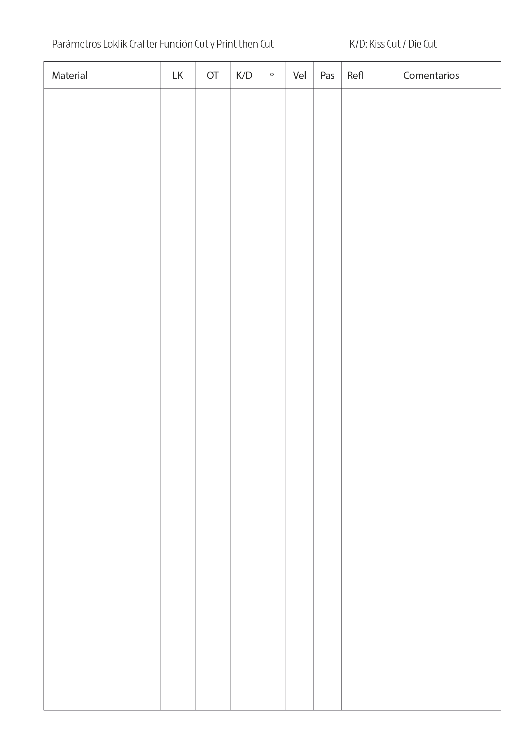

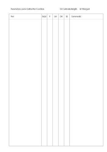

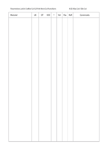

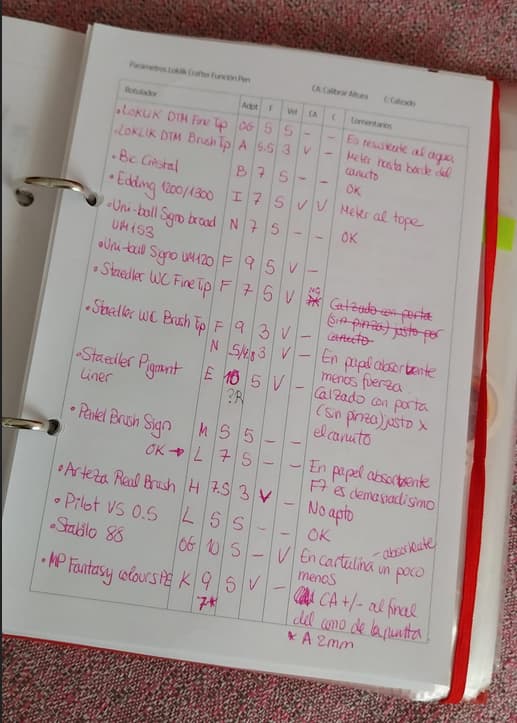

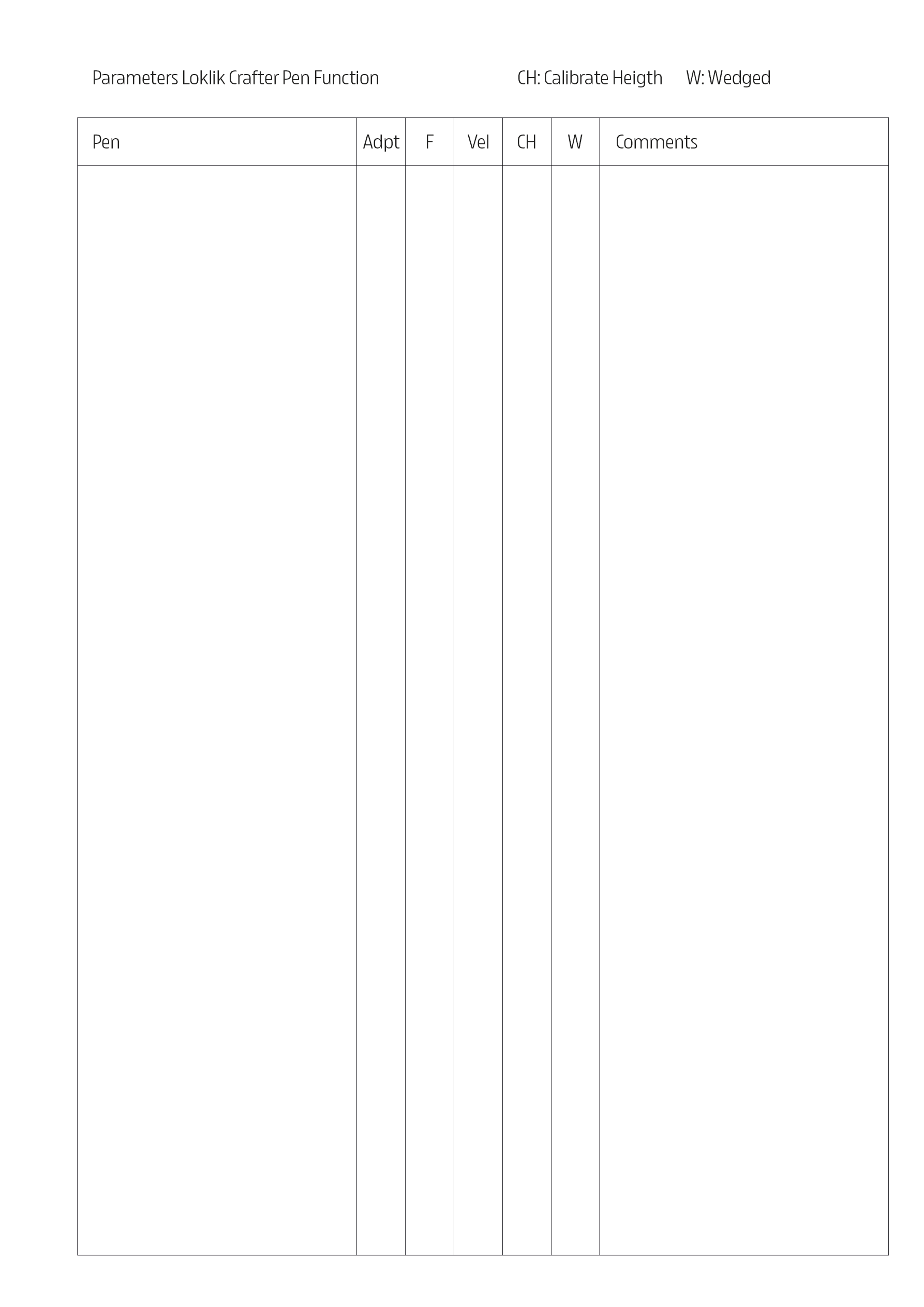

First sheet is Cutting and Scoring, second is Pen Adapter drawing force (it’s for my adapters set, but may be helpful)
Here is the table template in case anyone wants to use it to take own notes:
And this is the Pen Adapters’
Feel free to use or ask about any of my notes. Many members will help you out too with any specific settings.
