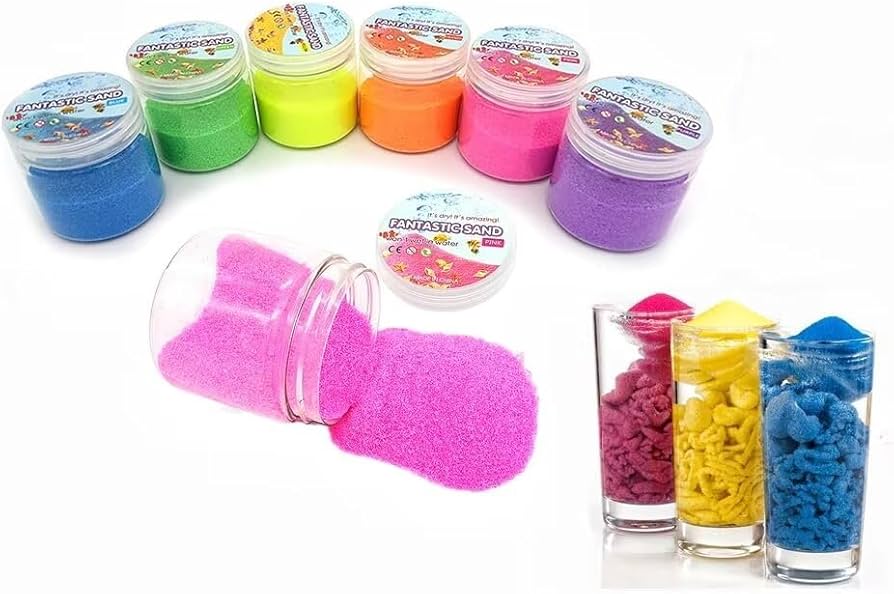

If you’ve ever tried to laser engrave an oddly shaped item and found yourself fighting gravity, rolling blanks, or awkward clamping solutions, this trick might become your new favorite shop hack. Magic Sand or Kinetic Sand can be used as a custom, reusable jig that gently but securely holds items in place during laser engraving. It’s simple, flexible, and surprisingly effective.
Why Magic Sand Works So Well
Magic Sand has a unique texture that allows it to be molded like wet sand while remaining dry to the touch. Once shaped, it holds its form without hardening, making it perfect for supporting curved, tapered, or irregular objects. Unlike rigid jigs, it conforms to your piece, cradling it evenly and reducing the risk of shifting during engraving.
What You’ll Need
A shallow tray, engraving bed, or scrap box to contain the sand
Your item to engrave
A laser safe surface or honeycomb bed
Optional masking tape for alignment reference
You can usually find Magic Sand in the toy aisle of big box stores, craft stores, or online retailers. It’s often marketed as a sensory or play sand, so don’t overlook the kids section when you’re shopping.
How to Create the Sand Jig
Start by placing a layer of Magic Sand into a shallow container or directly onto your laser bed if it’s protected. Press and smooth the surface to create a flat base. Gently nestle your item into the sand, pressing just enough to create a snug cradle that prevents rolling or movement. For cylindrical or rounded objects, rotate the piece slightly while pressing to form a custom groove that matches its shape.
Once the item is seated, double check that it is level and aligned with your laser’s focal point. Adjust the sand as needed by adding or removing small amounts until the engraving surface sits exactly where you want it. Because the sand holds its shape, it will stay put once positioned.
Engraving Tips and Best Practices
Always test focus and framing before engraving to confirm nothing shifts. Keep the sand clear of the engraving area and away from moving parts. Avoid high air assist directly on the sand as it may cause minor displacement. After engraving, simply lift the item out and reshape the sand for the next project.
Why This Hack Is a Game Changer
Magic Sand jigs are reusable, adjustable, and perfect for one off projects where traditional jigs fall short. Whether you’re engraving ornaments, stones, curved wood, acrylic shapes, or small keepsakes, this method gives you control without stress.
Sometimes the best workshop solutions come from the toy aisle.
