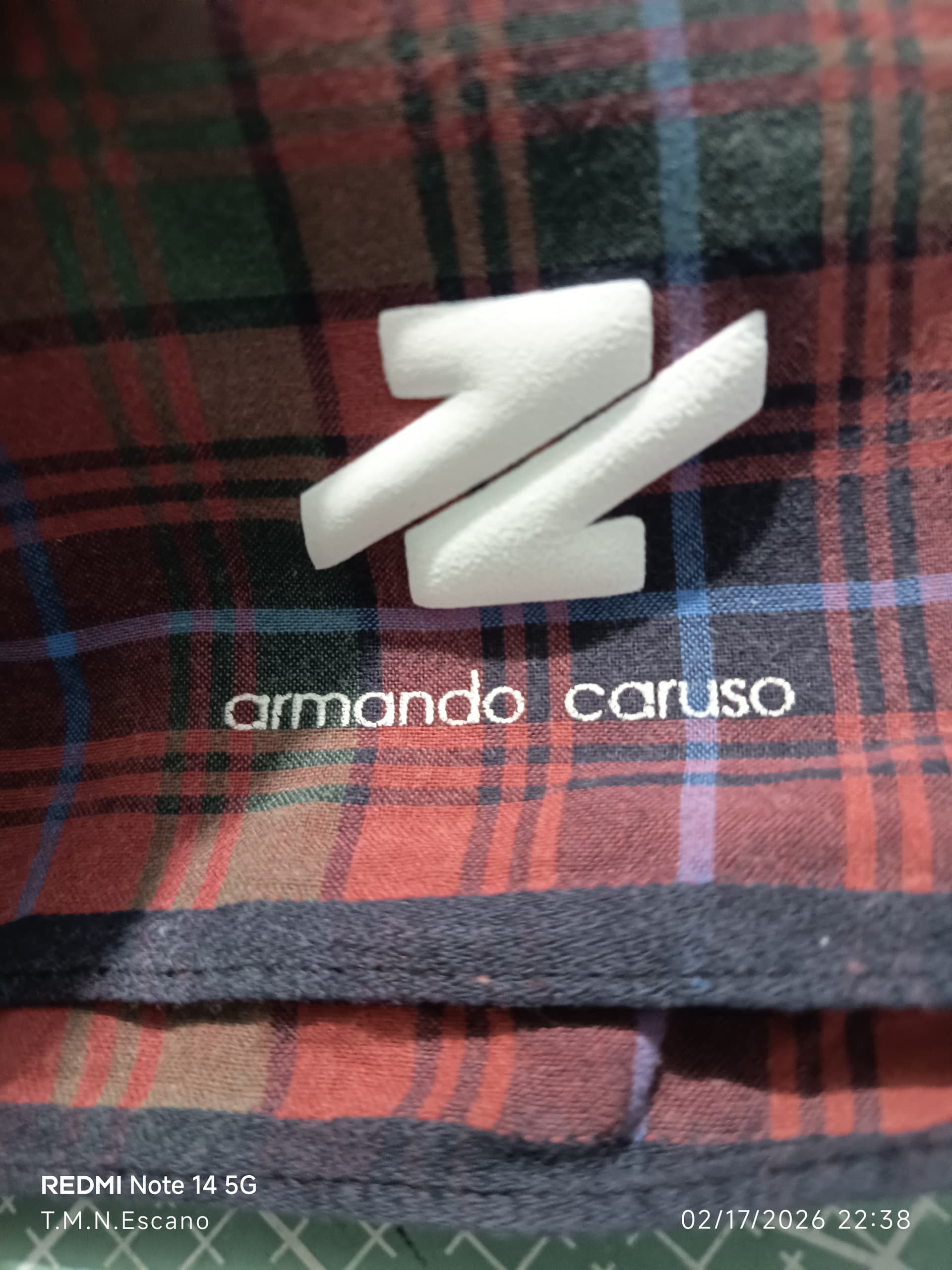

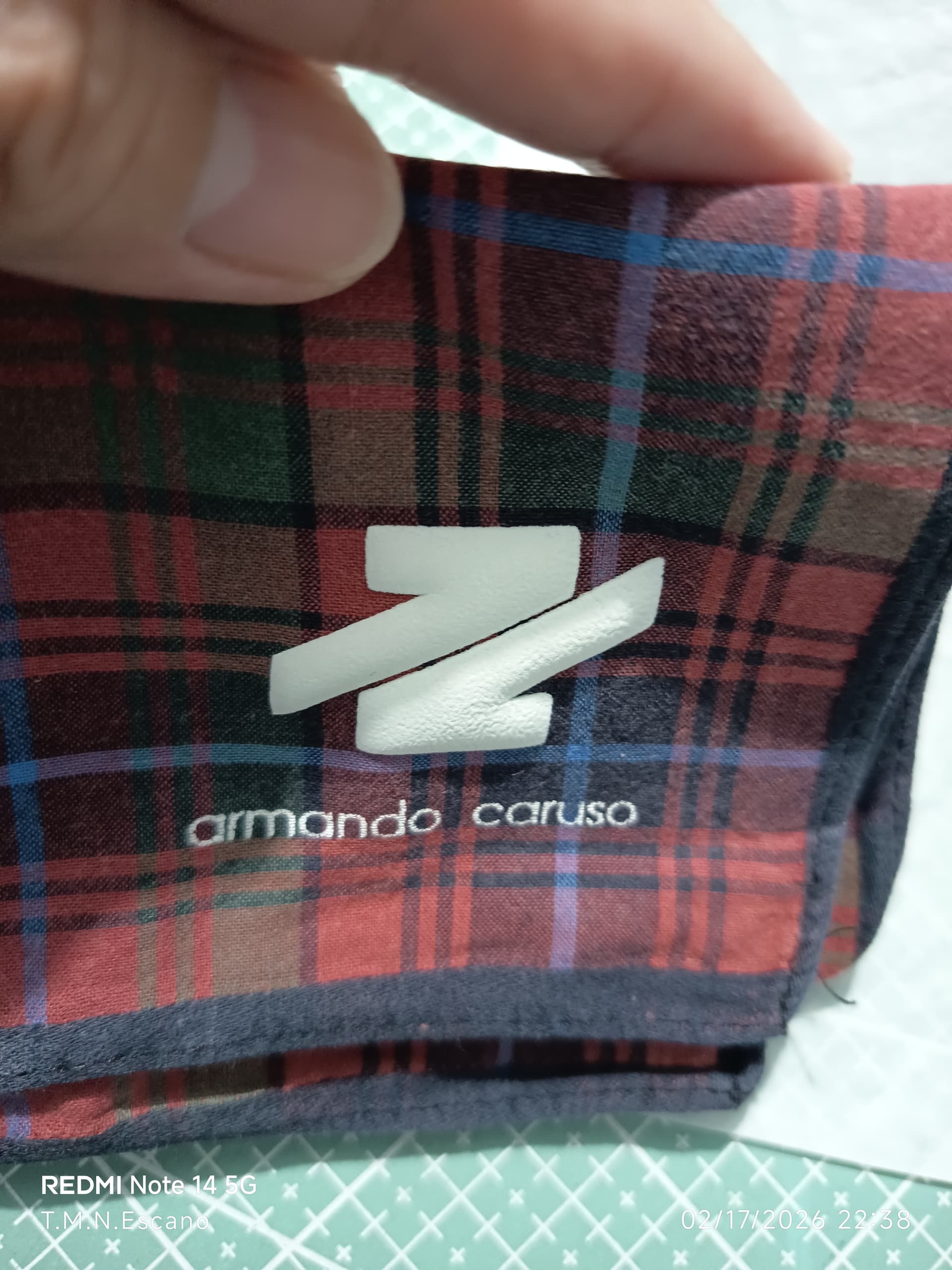

Tried again puff htv. I used my loklik mini press 3 on this hanky
Wow! :hushed: Great results! You got a good puff with that mini press! :heart:
I do like the output. I used a base which had a smooth hard surface, then much pressure while pressing, temp was 180 10 seconds 2 presses :smiling_face_with_three_hearts:
Thanks for the info! I will certainly give that a try on my next puff press. I didn’t even know pressing puff twice was doable, but I’ve seen others say to give it a 2nd press, too. :heart:
The siser brand usually needs 2 presses. On this project, I noticed the htvront puff didn’t puff as much so I pressed it another time with more pressure
Yeah, the HTVRONT definitely didn’t puff as much as I expected it to. It’s the only brand I’ve tried as far as puff goes. Think I’ll do some experimenting with it soon. The way the carrier sheet just pretty much removed itself after the first press, I thought 1 press was all that I could do. :laughing:

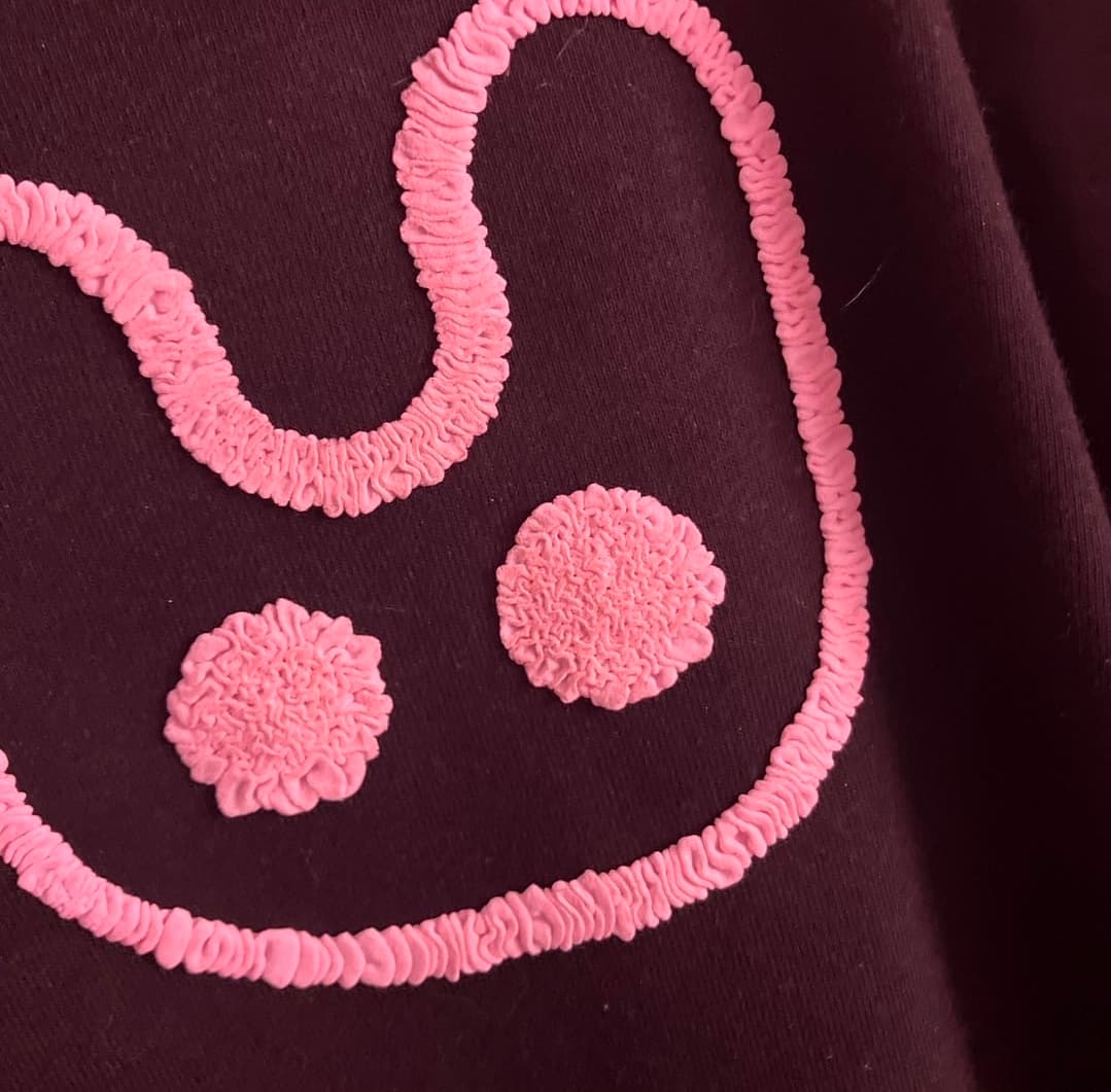

:joy: Yeah, mine was a little brainy, but not like some I’ve seen. Like this one:
The HTVRONT website says different colors have different textures, so I just thought the color I was using was brain texture. :joy: I’ve only ever used the one color — pastel purple — so I don’t know what the other colors do, yet.
I think the surface or mat also plays a big part. Don’t use the mat that came with the heat press. It’s too soft, try the silicone rubber mats instead that are firmer. For this project, since I only used the mini press and did this out of a whim, I pressed it on the self healing mat on my table. I think the result was okay for this. The only problem was since I pressed it on a surface that’s not heat resistant, the lines of on my self healing mat smudged a little :woman_facepalming::sweat_smile: I forgot to protect my self healing mat :woman_facepalming:

I don’t have the HTVRONT Auto Heat Press, but I have the H10, and they sent me one of their pressing pillows for when I did my Hands-on Review for it, and I did use it my first time. The other time, I used the pressing mat that came with my 5 in 1 swing arm press. It’s firmer than the pressing pillow, and if I’m remembering correctly, I did get a little bit better of a puff. I’ll have to look into the silicone mats, for sure. The image I sent isn’t mine, I was just using it as an example of those that I’ve seen. :laughing: I thought it was a pretty cool texture, too, but apparently, if it puffs like that, it will crackle & fall off pretty quickly. I think they said it was due to too much heat. So, there’s a fine line between too much, too less, and just enough heat to get the perfect puff. At least, that’s what I’ve gotten from my research on it.
