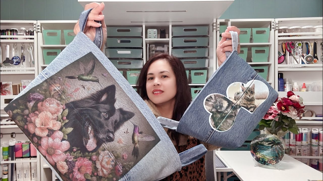

Sublimation on Jeans | DIY Storage Bins for Pets’ Toys | Upcycle Jeans | UPDATED!
MACHINES USED:
🩷HTVRONT Auto Heat Press 2
🩷BROTHER XR 1300 Computerized Sewing & Quilting Machine
🩷Cutting Machine
🩷Sublimation Printer
HEAT PRESS SETTINGS:
Fusible Fleece - 305 F, 10 seconds with 150 # of pressure
Sublimation for both HTV & Paper - 395 F, 45 sec with 150# pressure
MATERIALS USED:
🩷HTVRONT Sublimation HTV
🩷HTVRONT Sublimation Paper (125 gsm)
🩷4 pair of old jeans (light & dark colors)
🩷Pellon Fusible Fleece 987F medium weight
🩷Matching thread, pins
🩷Schmetz Sewing Machine Jeans Needle Size 16
🩷4 1/2" square ruler, hem gauge, tape measure, 12" ruler
🩷Frixion pen/fabric marker or pencil
🩷Scissors, rotary cutter
🩷Self-healing Cutting Mat
🩷Ngoodiez Sublimation Coating Spray for 100% cotton
🩷Sublimation Designs
🩷Air Purifier (optional)
Finished size (wide x deep x tall)
MEDIUM - 7" x 7" x 6 3/4"
X-LARGE - 9" x 9" x 8 3/4"
Time expenditure: 7 hours and 30 minutes
Sewing difficulty: Beginner
FULL VIDEO TUTORIAL WILL BE FOUND IN THIS LINK BELOW:
UNDERSTANDING THE SUBLIMATION PROCESS
Sublimation is a chemical process where heat turns solid dye into gas, which then bonds with polyester fibers. It’s not just “printing”—it’s embedding the ink into the fabric itself. For sublimation to work properly:
  • The substrate must contain polyester (or be coated with it - which I did in this tutorial!)
  • The ink must be “sublimation ink” - which is I have installed to my sublimation printer.
  • The process involves “heat and pressure”, typically using a heat press - which is I used in this video
Jeans, however, are usually made of cotton or denim, which don’t bond with sublimation ink so for both bags, I used different type of substrates:
SUBLIMATION SPRAY COATING AND SUBLIMATION HTV and of course with Sublimation paper and sublimation ink.
