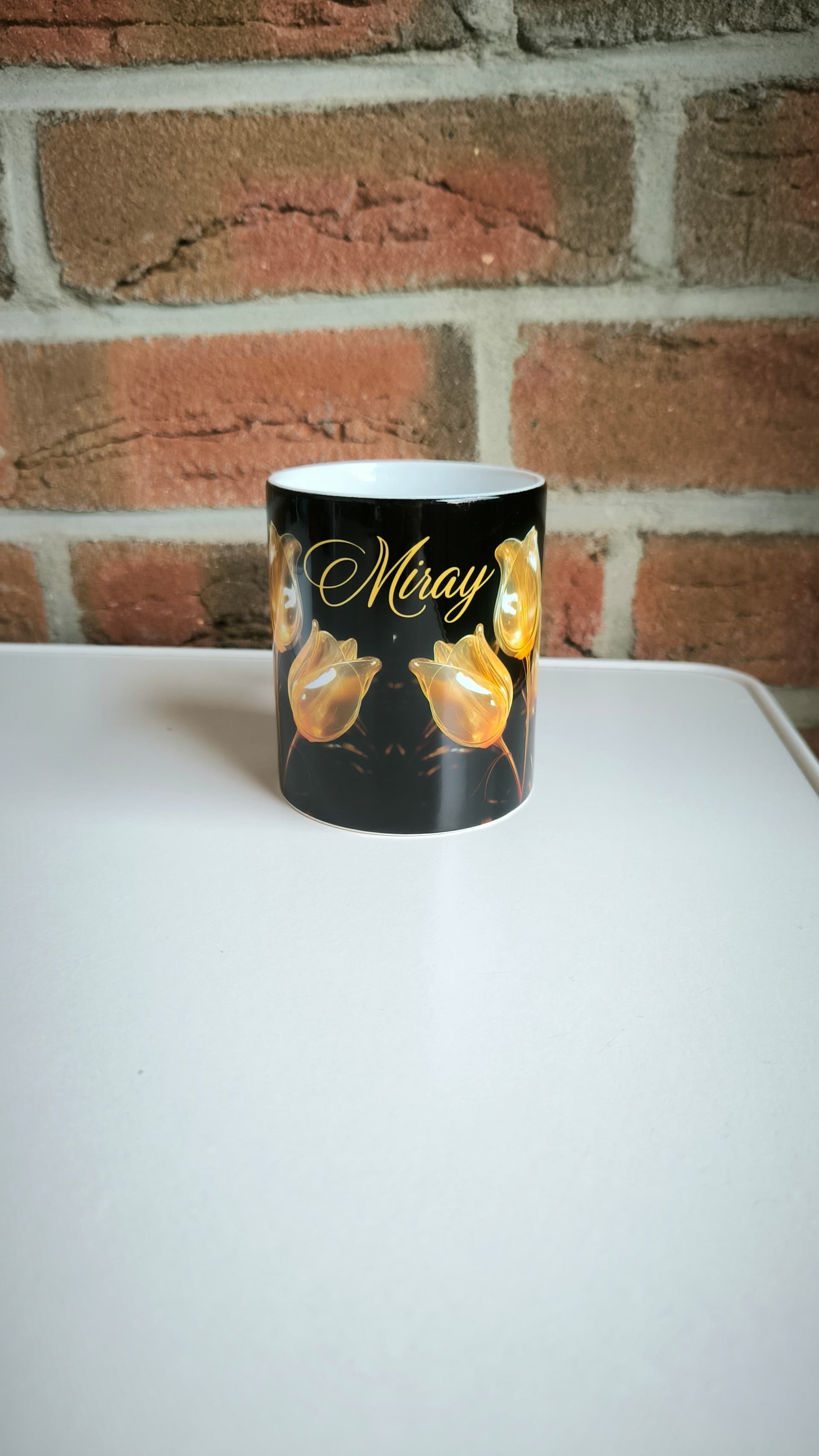

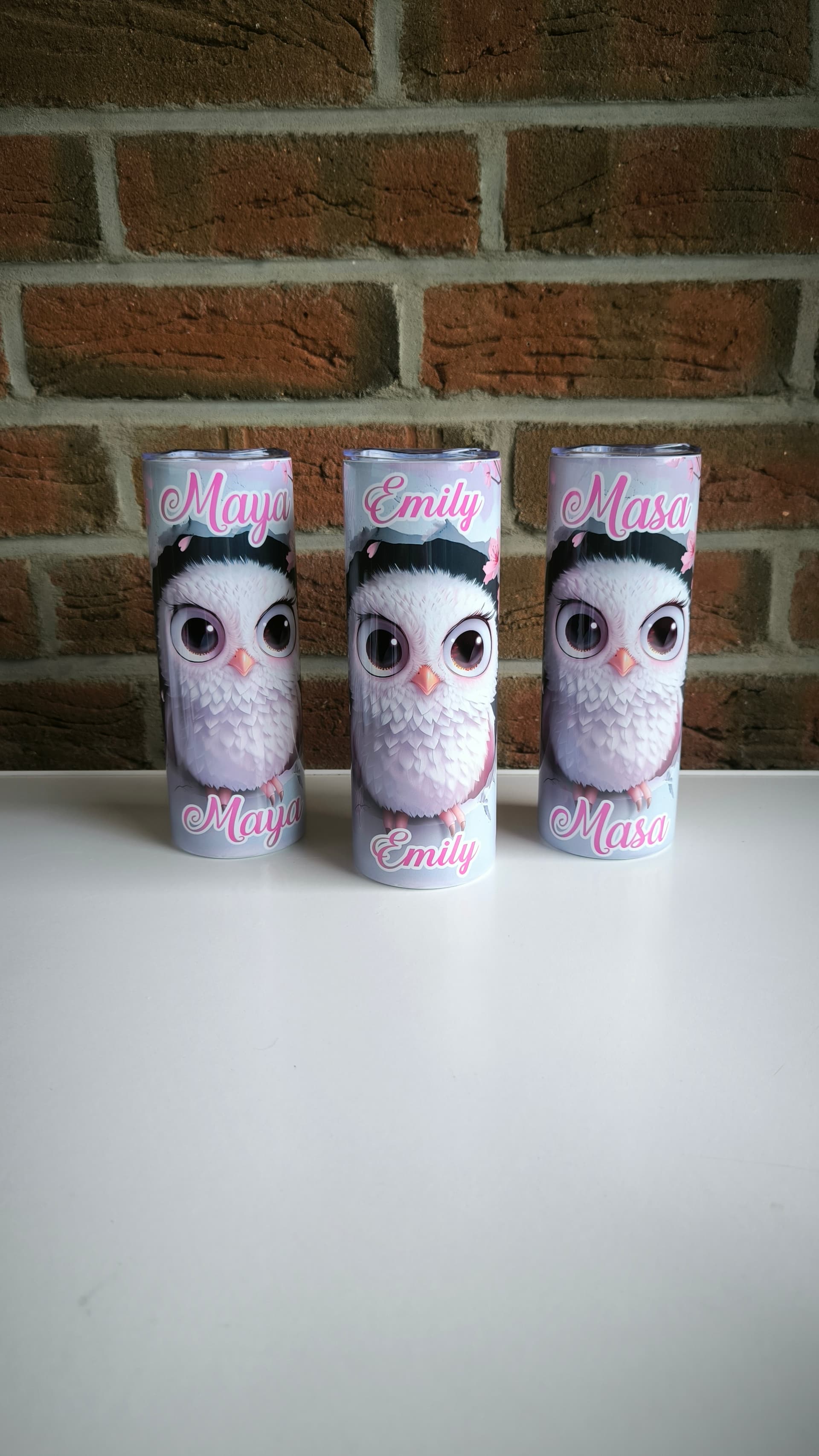

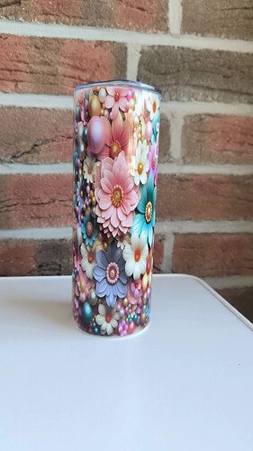

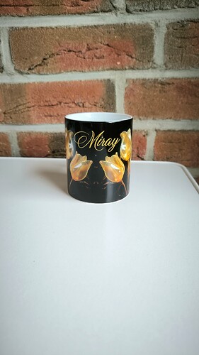

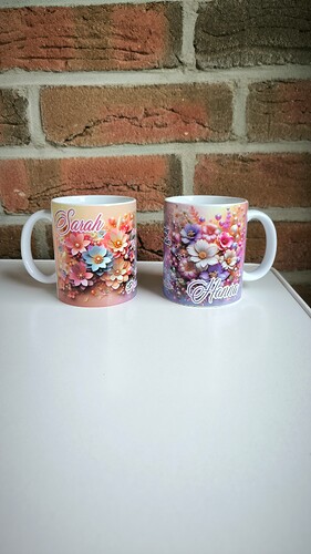

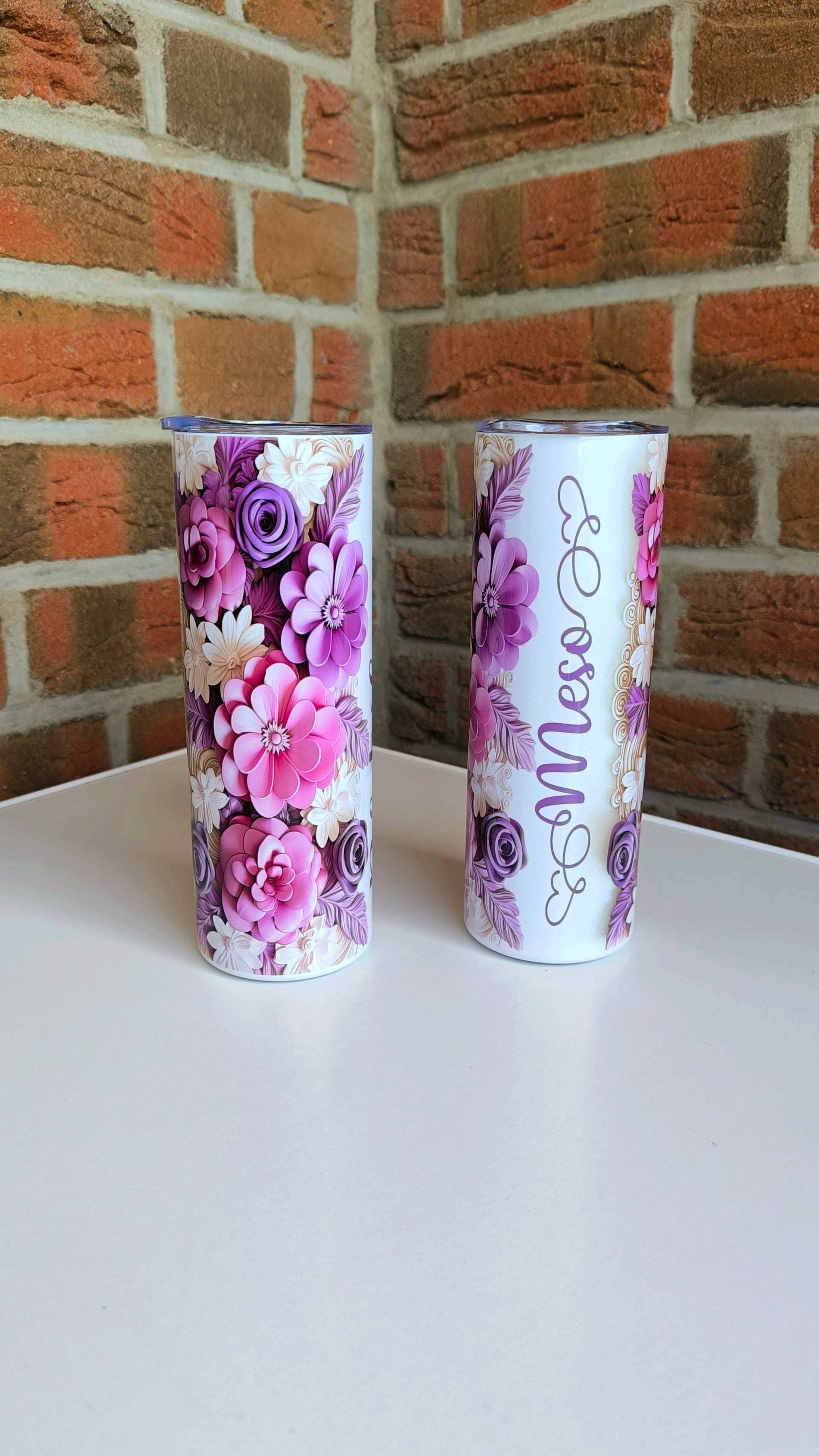

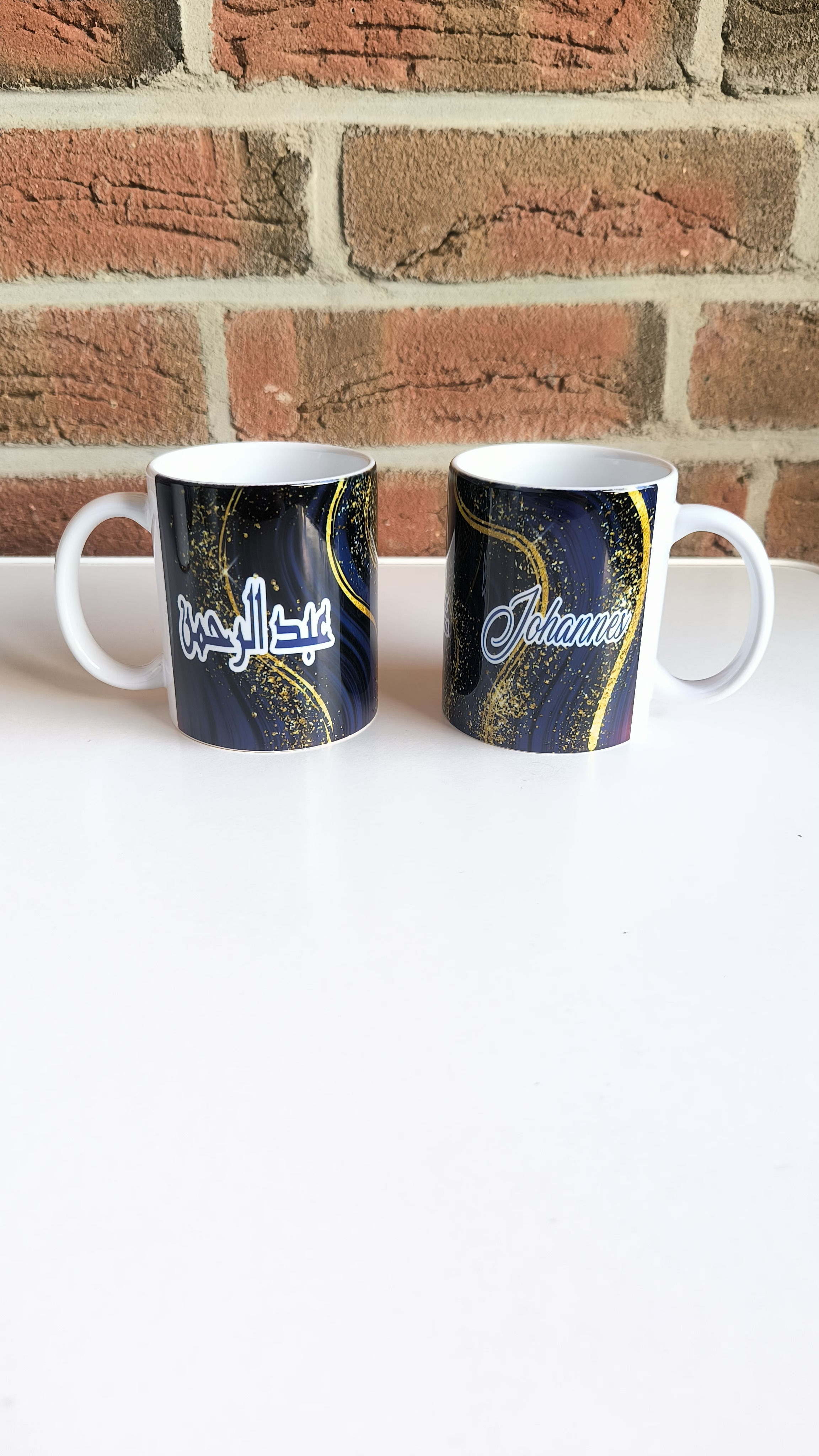

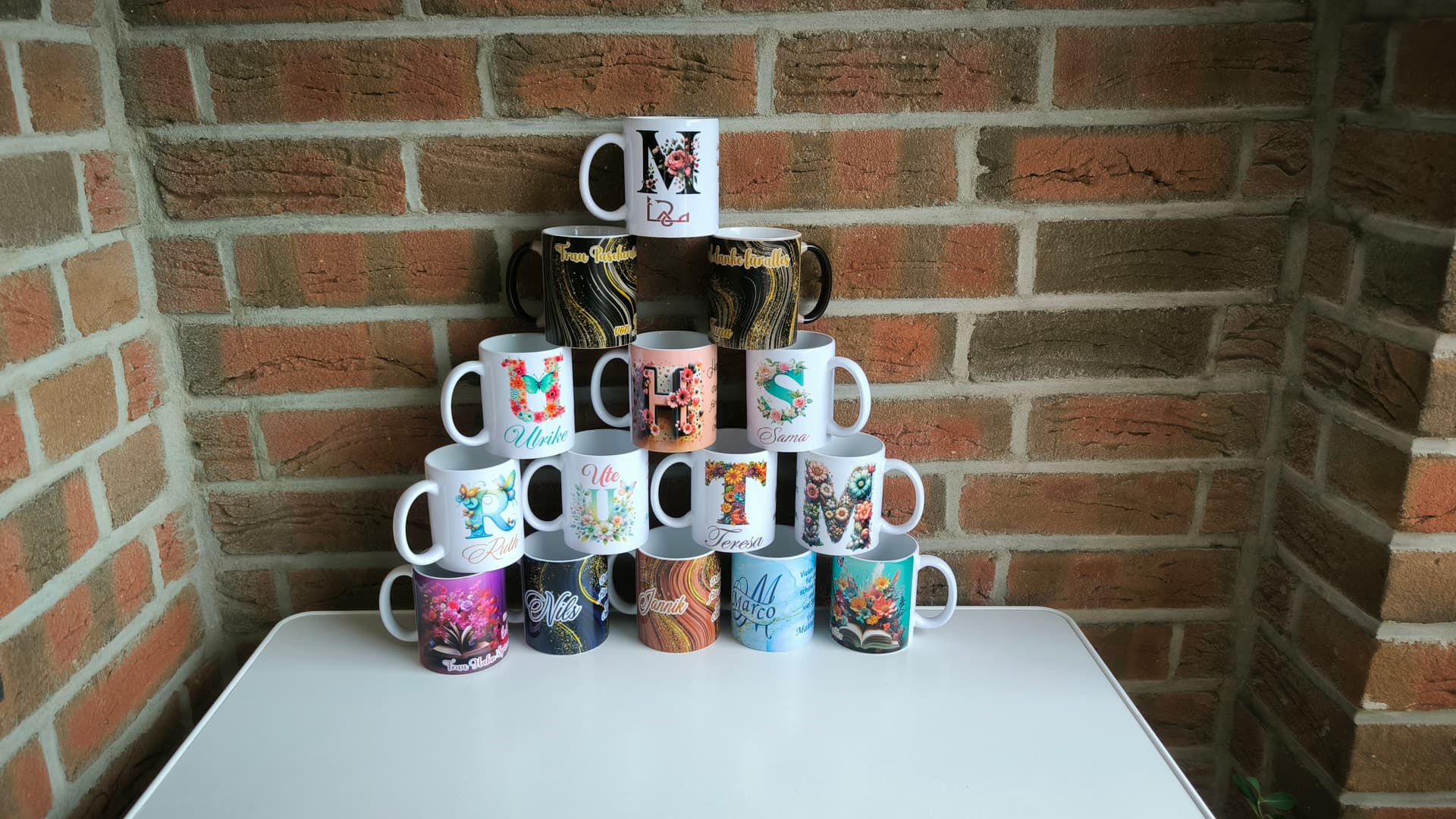

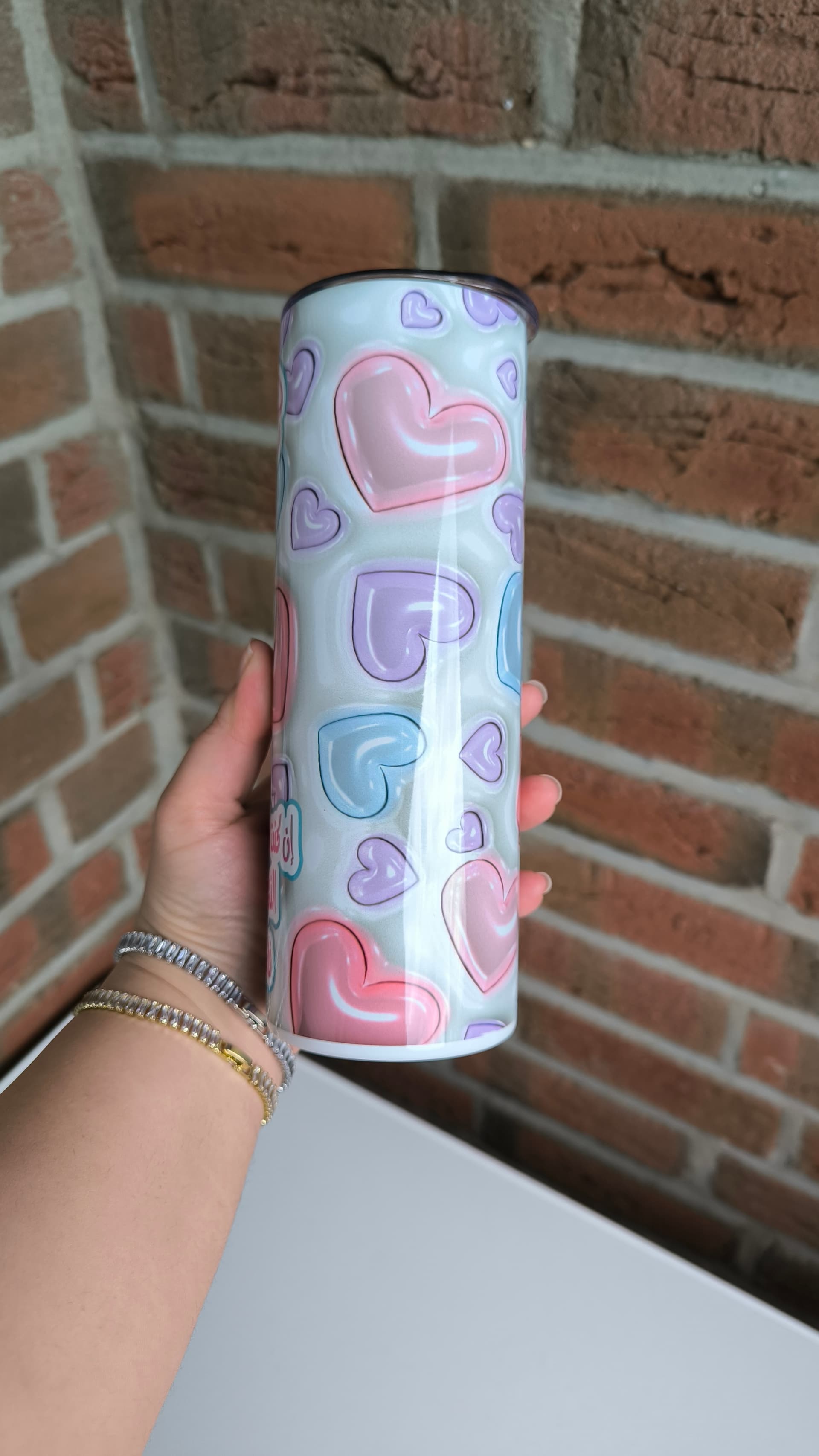

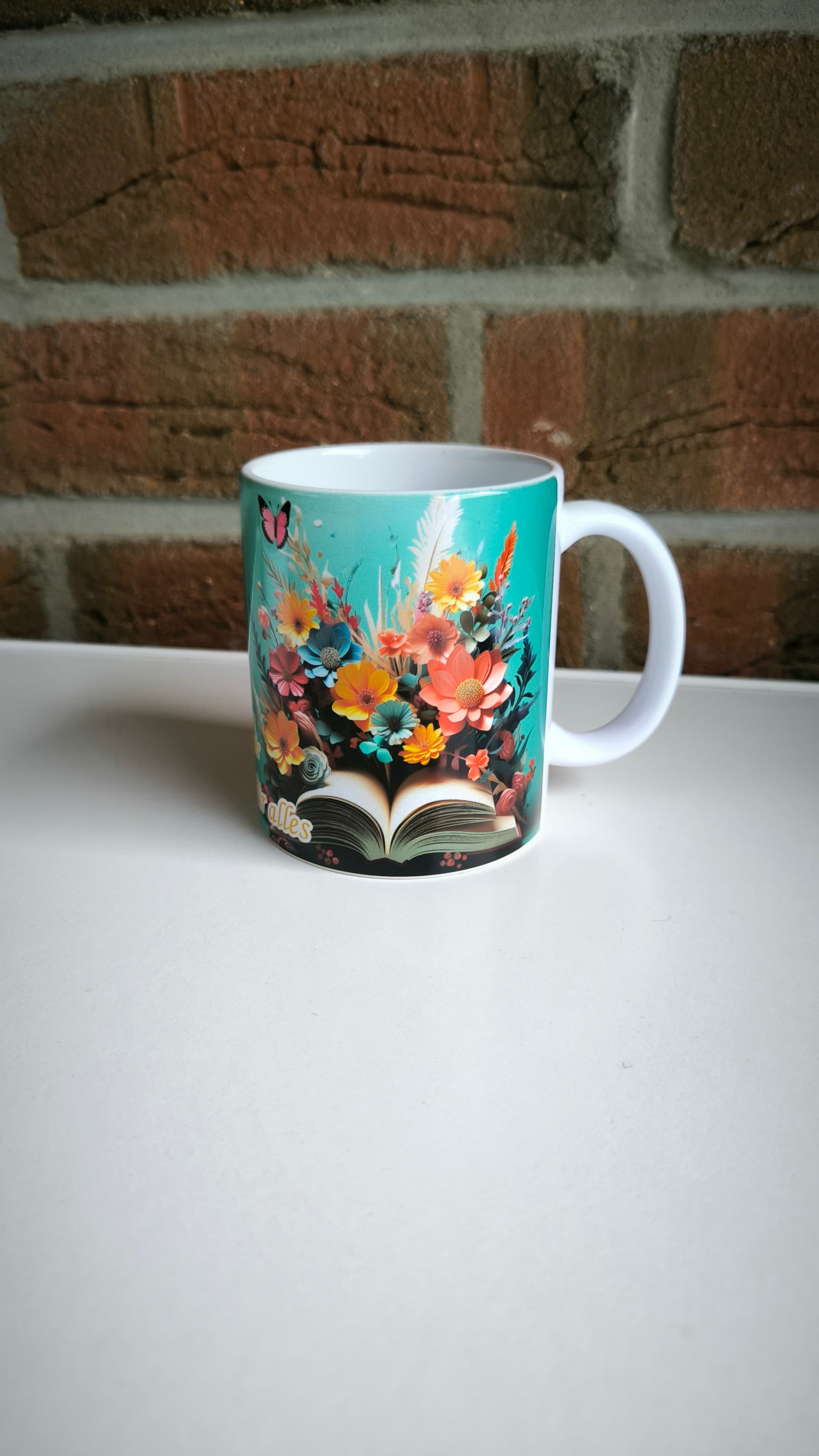

From my personal experience I’m loving it :star_struck:
Since I got it I didn’t have any problems all my prints are perfect I do ceramic mugs and stainless steel tumblers. Of course I use original pictures which makes my prints show more accurate and pretty.
The size of the mugs 11 oz
The size of Tumblers 20 oz and less
My settings are 195° Celsius for both
I do thmugs for 240 seconds and if the design has lots of black for 300 seconds
The tumblers for 180 seconds and if you see the press close all the way on the tumbler then you don’t need to rotate it.
But if you are doing a smaller size than the 20 oz you need to rotate.
I bought glass cans, but didn’t try them yet.
That’s my experience with the tumbler press :blush:
I hope you share your thoughts and opinions!
Your community friend
Marin :wink:
