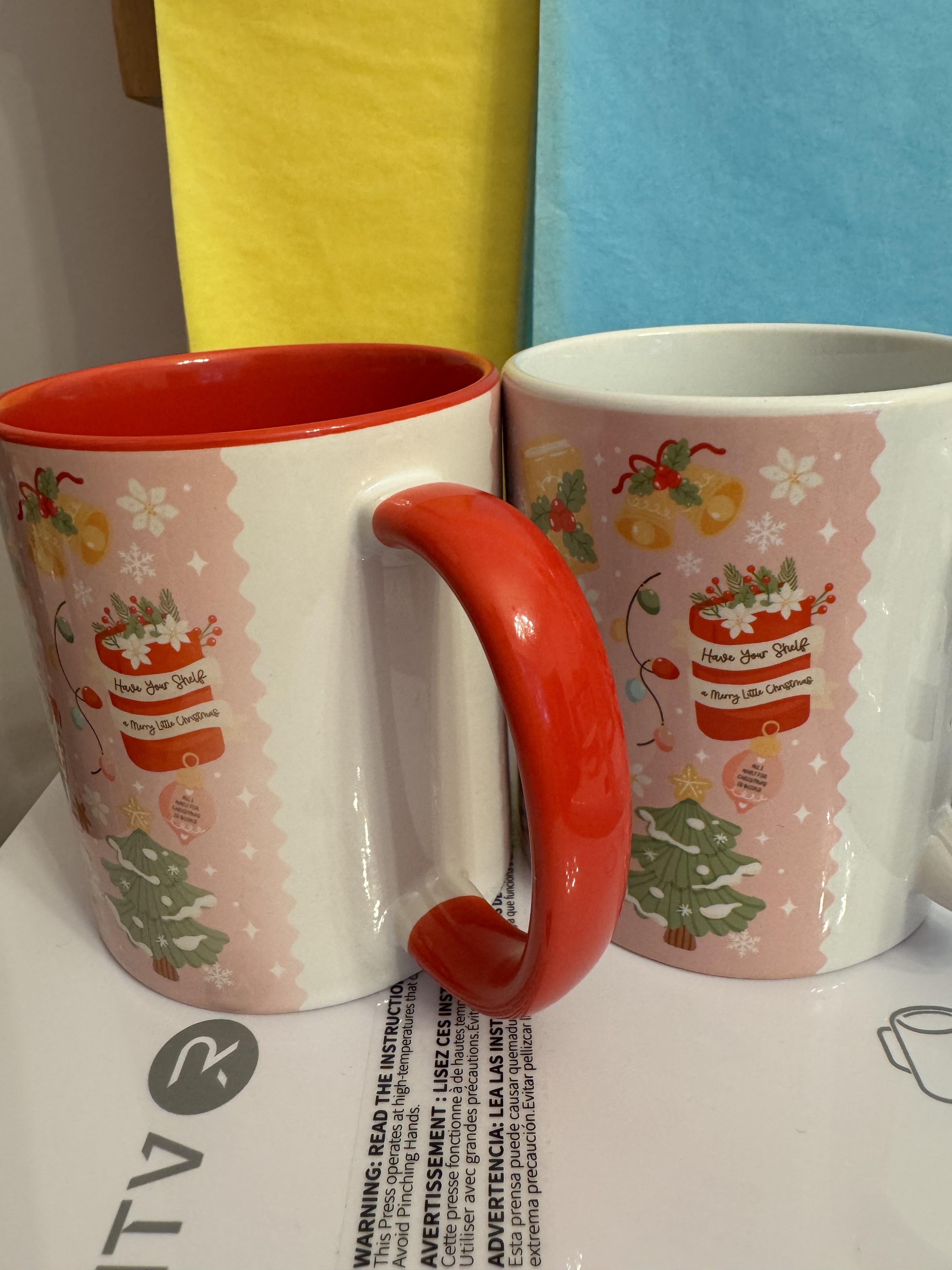

They all look wonderful. Thank you for letting us know your heat settings. May I ask what size (width) you make the design for an 11oz mug? I am making mine at 21.8cm and sometimes they look fine but sometimes I get ghosting so trying to figure out what the best size would be. Thank you!
Hello dear Tina , 21.8 cm is too much I’ll check exactly as soon as I open my Laptop but for 11oz mugs I’m pretty sure I do the designs between 20. 9 and 21.3 cm no more than that with the Tumbler press we will get ghosting (with any mug press) because the heat won’t affect the sides of the mug as it does to the rest , but when using an oven or airfryer you can wrap the whole mug .
And one more information it’s daid to stay away from the handle feom 1 to 2 cm both sides .
Or your thumb should fit between the handle and the design :sweat_smile:
Thank you, Marino, for the information. If you could confirm the exact measurements, that would be really helpful! I’ve wasted quite a few mugs trying to get the right temperature and sizing. Some full-wrap mugs turned out perfect at 240 seconds when I rotated them halfway through, but when I repeated the same process, the last one came out faded :thinking:. I also place a sheet of paper over the sublimation paper to prevent leaks. And one last question: do you peel the paper when it’s just out of the press or let it cool? Thank you :smiling_face_with_three_hearts:
OK dear I’ve checked my sizing is
20.8 to 21.2 maximum
