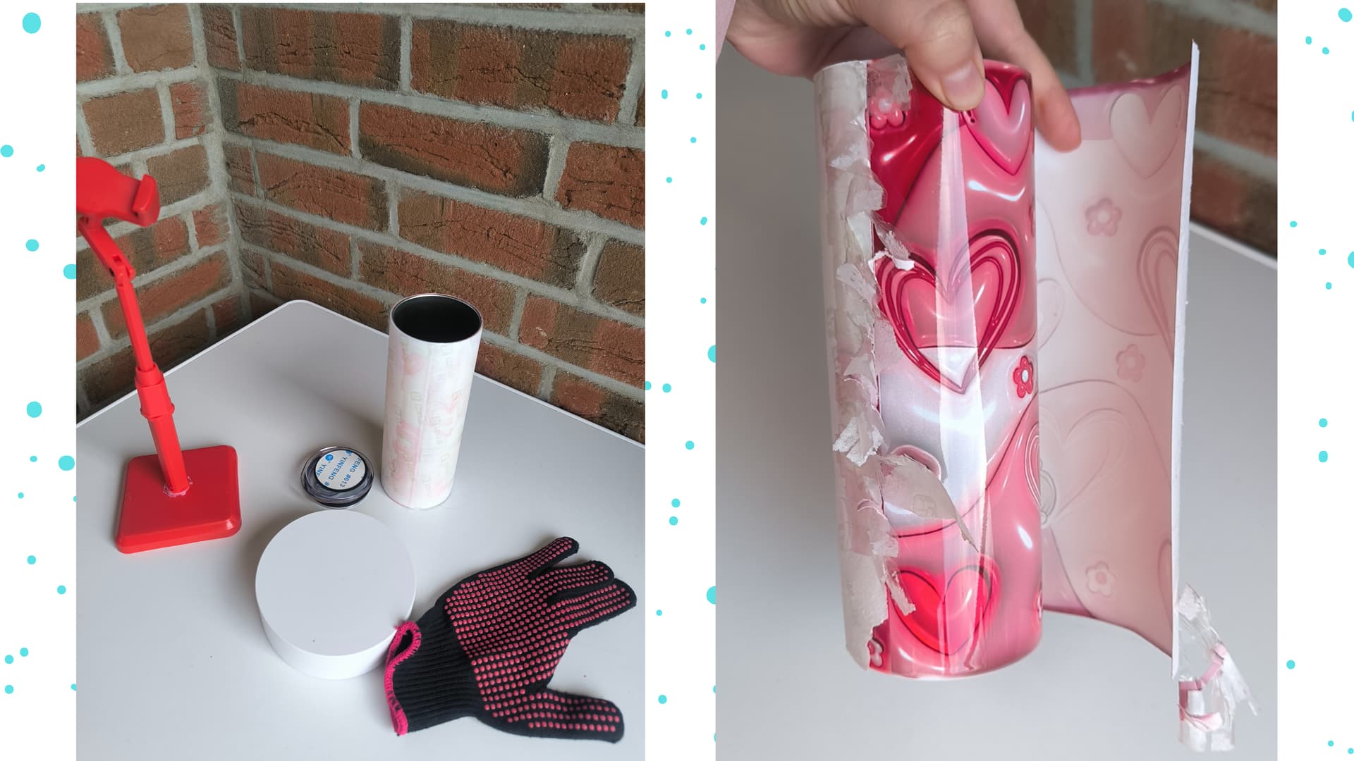

4.cut the printed design properly and be careful to not leave any white edges
5.golden tip I’m gonna give you a golden tip to make your seam line perfect
:black_small_square:Make the design bigger than what you need
:black_small_square:Tape down on one side of the paper exactly on the edge (better using a coloured heat tape so you can see where it’s placed)
6.the side was taped should be under the other one like showed in the picture
7.now we have to start taping the Tumbler all the way up the more the better specially if you are a beginner

:round_pushpin:Some people turn the Tumbler after 60 seconds I didn’t coz the one I’m using fits perfectly and the Tumbler press closed all the way through.
9.after the time finishes let the Tumbler cool down before peeling
10.last but not least start pealing the paper and don’t forget to film or take pictures :smiling_face:

Here’s the final project :partying_face:
