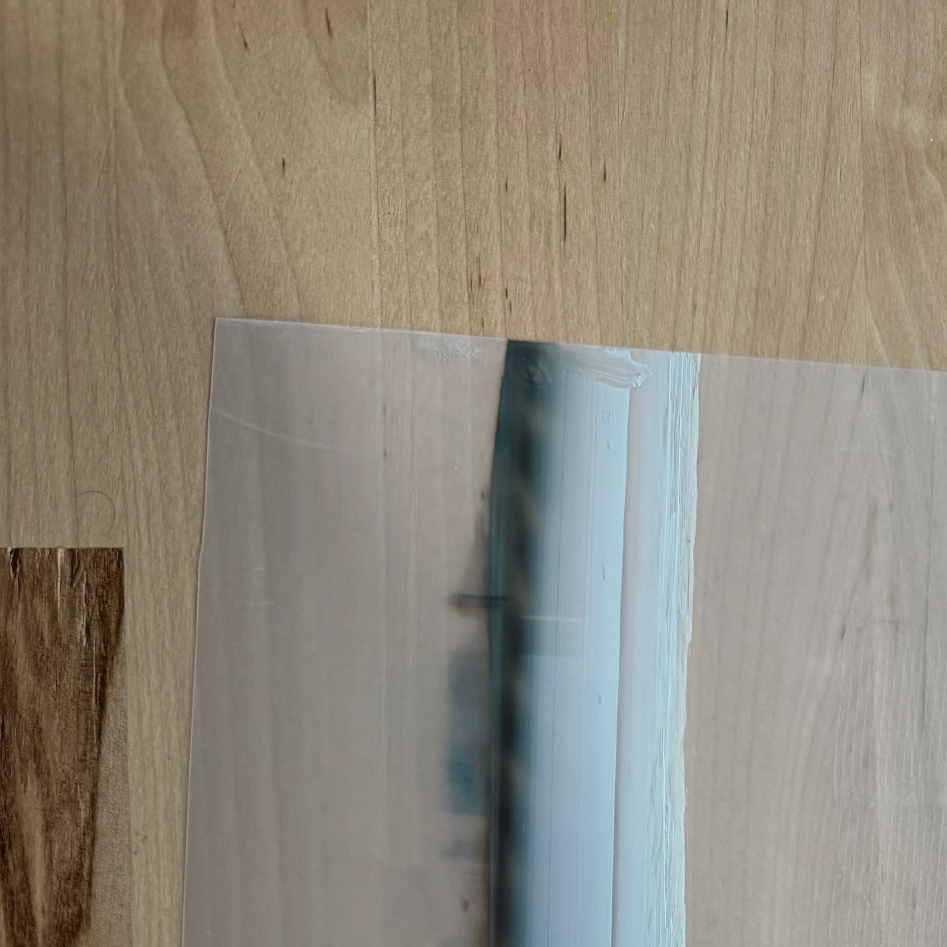

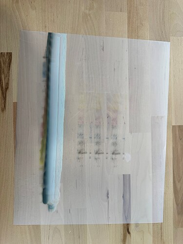

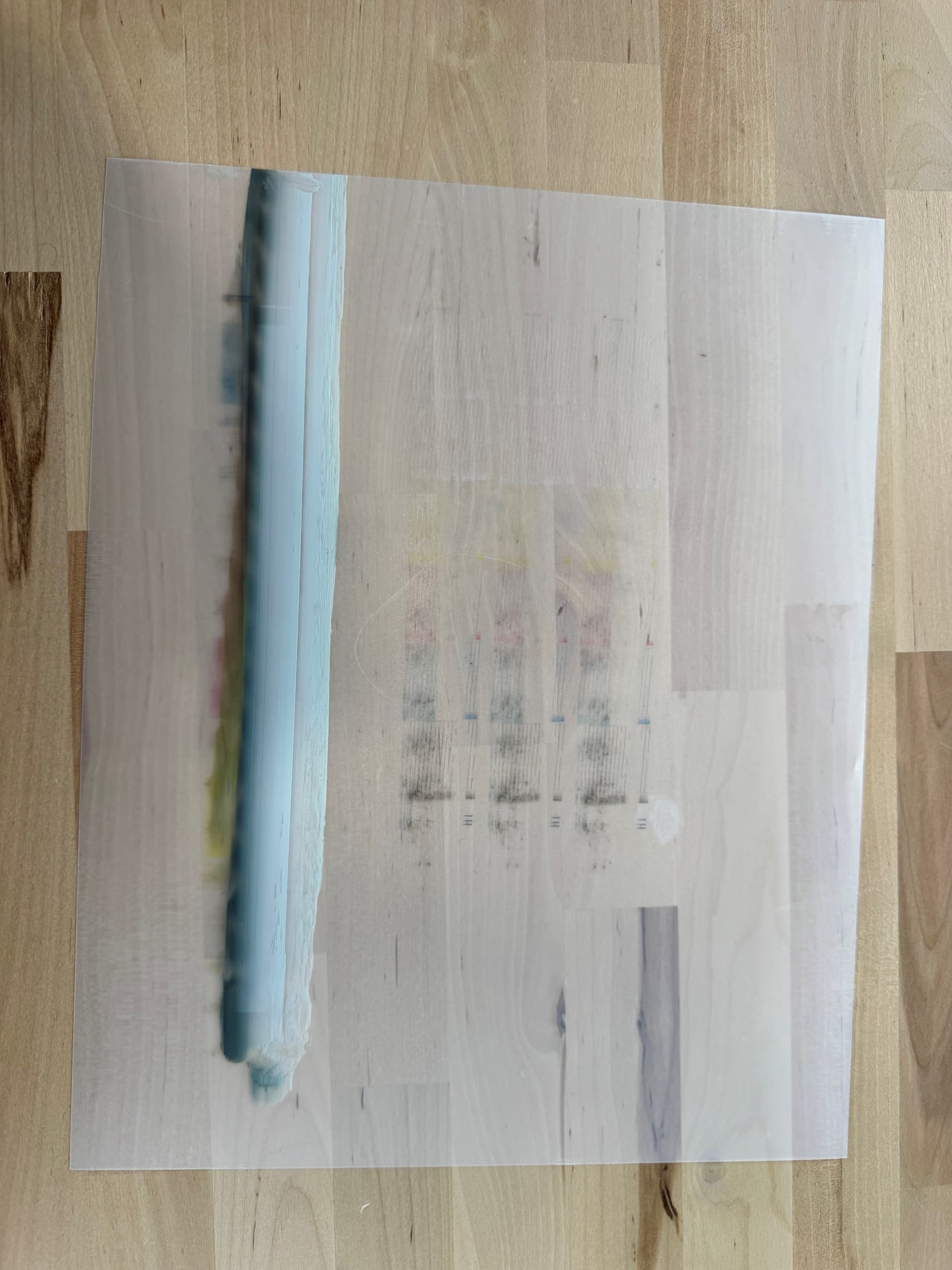

Ok little by little we might actual be getting somewhere. Here is a pic of what’s going on, I did the cleaning 3 times (the regular one) and did a pink, blue, yellow and white square (each color a dif square) and then just text in black. The photo shows the results of the 3 cleaning and the smudge :frowning:
Also the paper is loaded correctly and what is platen gap is correct
Hi, Ashley! Thanks so much for the images and explaining what you’ve done. That helps a lot.
It looks like you’re really close now — your colors are coming through and the head is moving correctly, which is great. The streak/smudge you’re seeing on the film isn’t a nozzle issue anymore. That kind of vertical smear almost always means the printhead is physically touching the film while it prints. When the head touches the film, it drags through the wet ink and leaves a streak just like the one in your photos.
At this point, more cleanings won’t fix it — you need to adjust the platen gap.

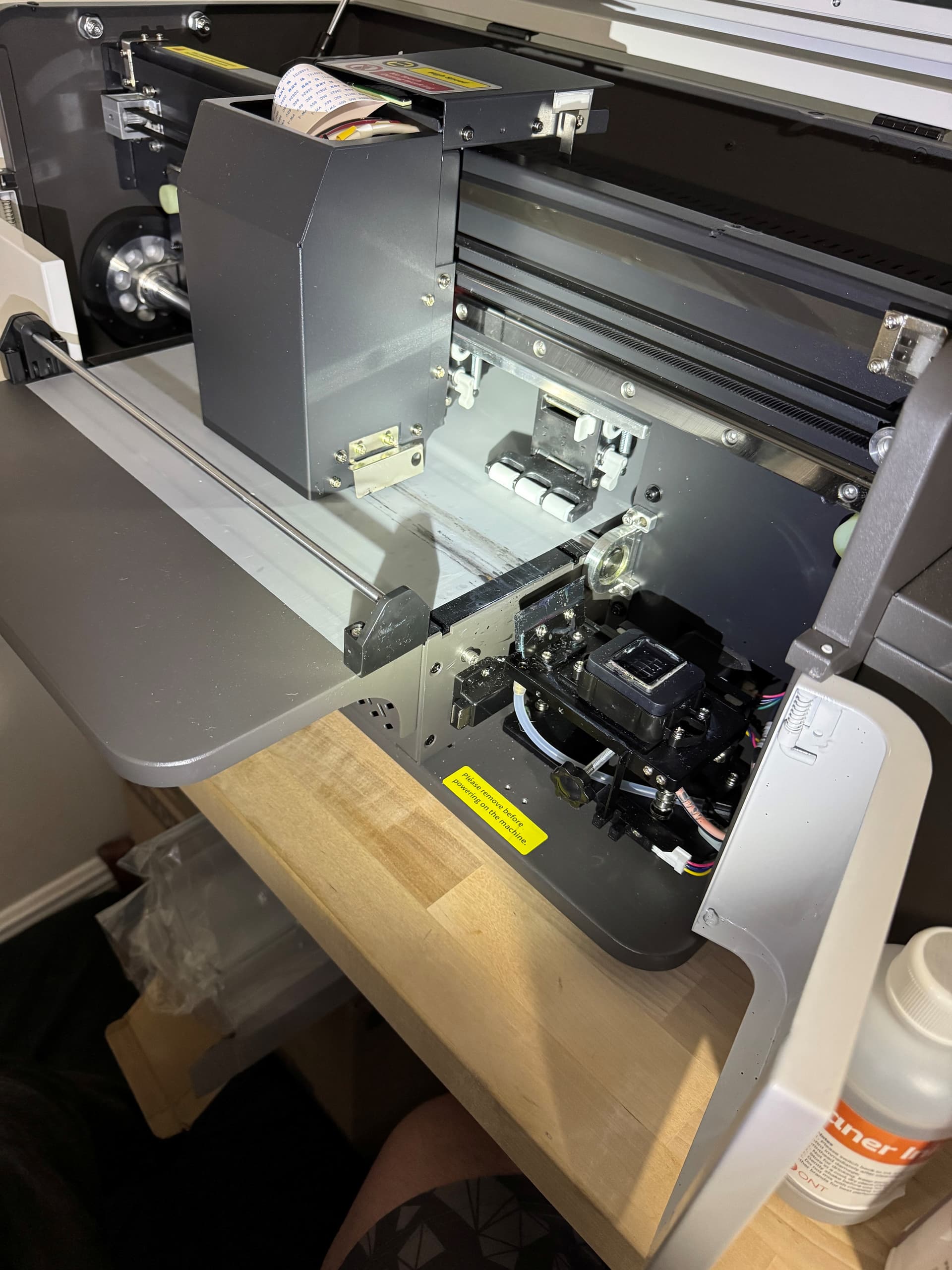

Can you please point out where I am suppose to adjust. My hubby and I can’t figure it out
:sweat_smile:
Thanks for the picture — that helps a lot. It looks like the D2 doesn’t have the same height‑adjustment knob the D1 uses, so there isn’t a user‑adjustable way to raise or lower the printhead on this model, as far as I can tell. If you’ve made sure the film is flat and you’re still getting that streak, this is something only Loklik support can fix from their side. I’d reach out to them so they can walk you through the internal calibration or replace the unit if needed.
