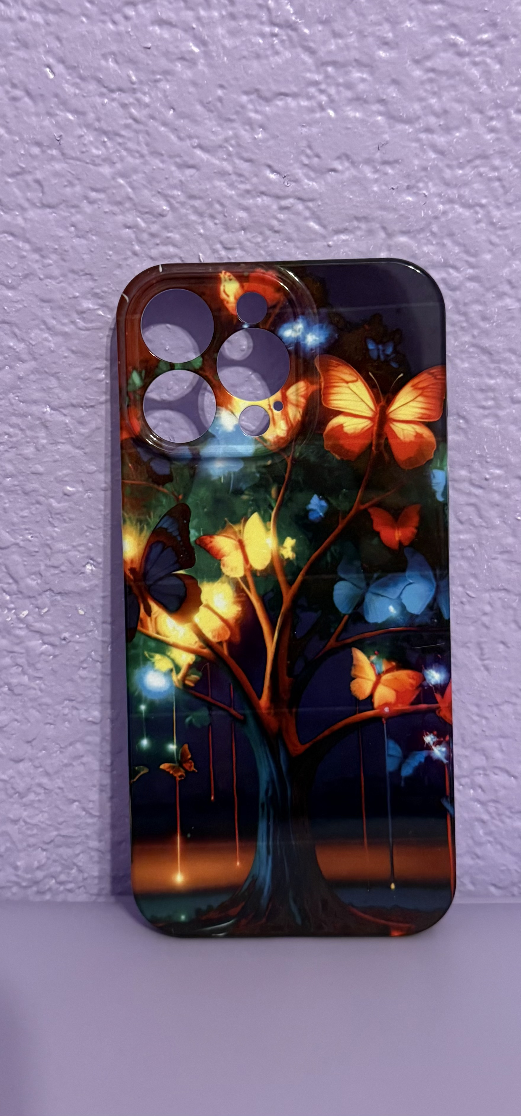

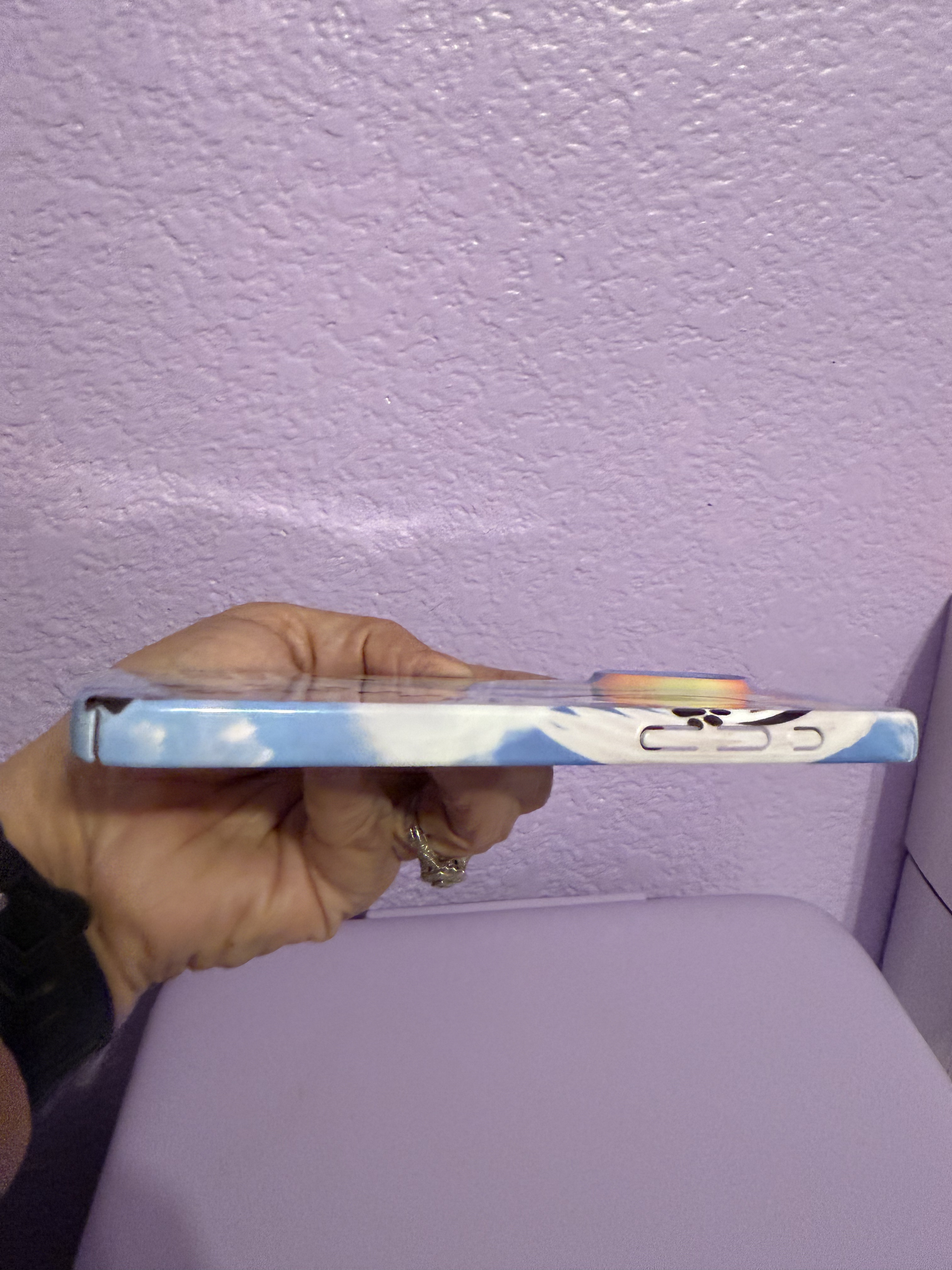

My first attempt was the butterfly tree and 2nd was my puppies.
Beautiful results :heart_eyes:
