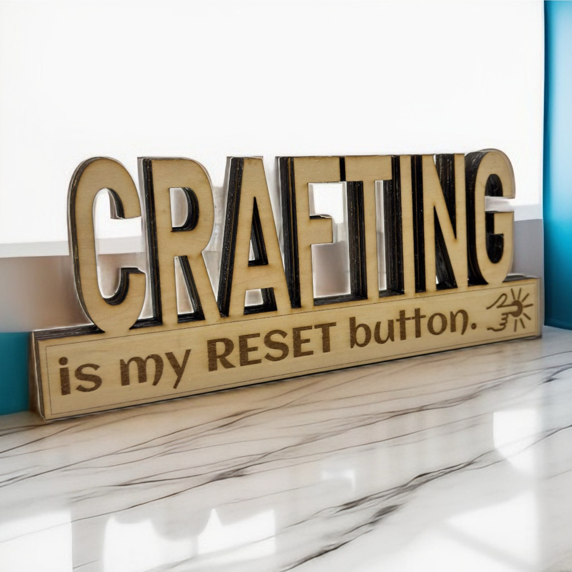

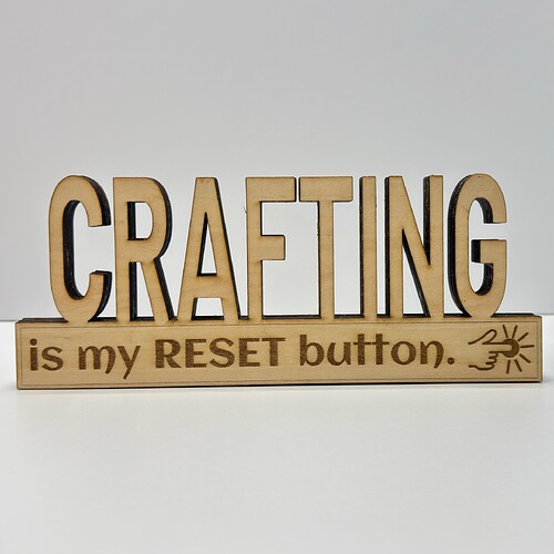

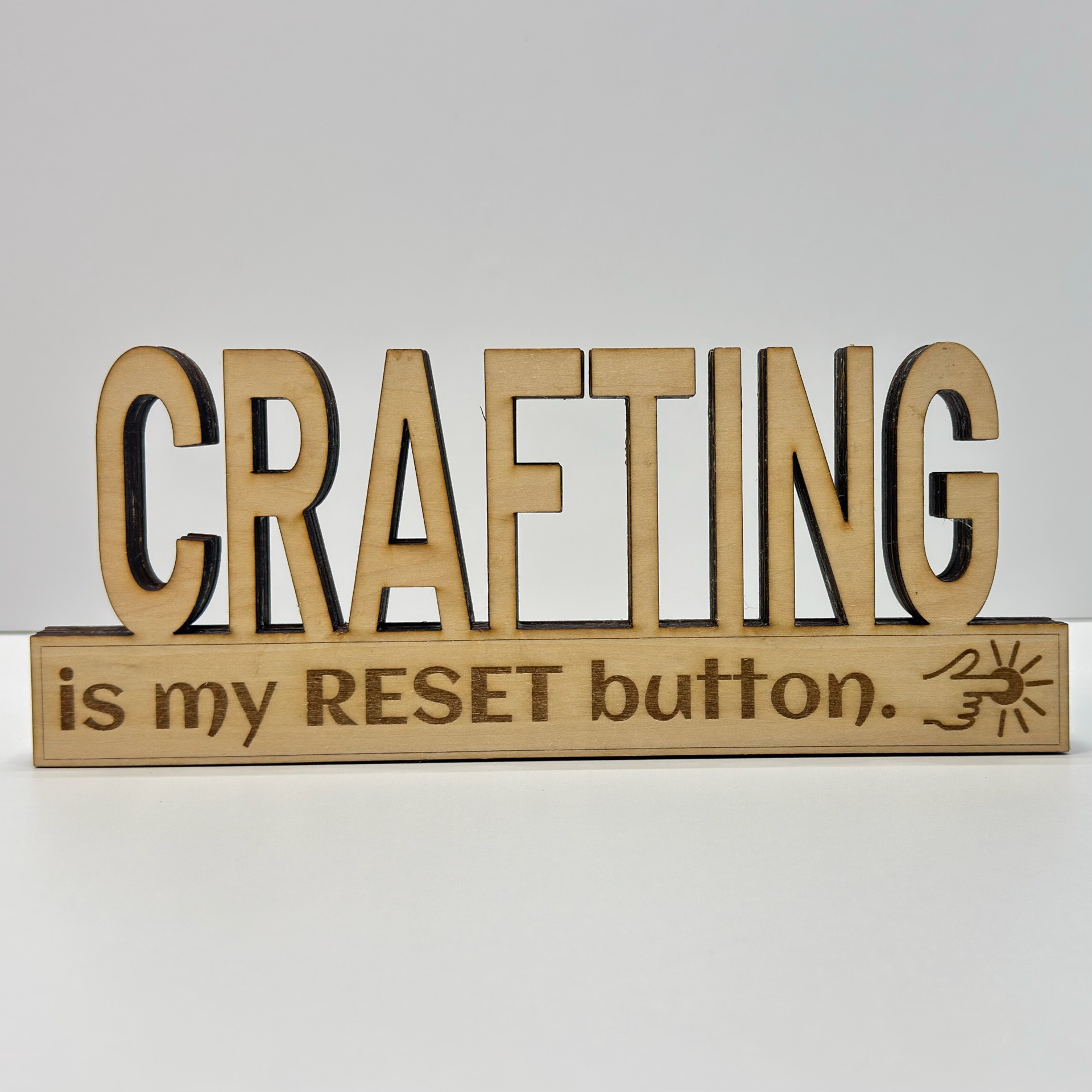

SOFTWARE USED: IS Desktop Version
MACHINE USED: LOKLiK iEngrave Cover Machine
FONTS USED: Poppins-bold and Aclonica.
DESIGN: Reset button sign was from Ideastudio Library.

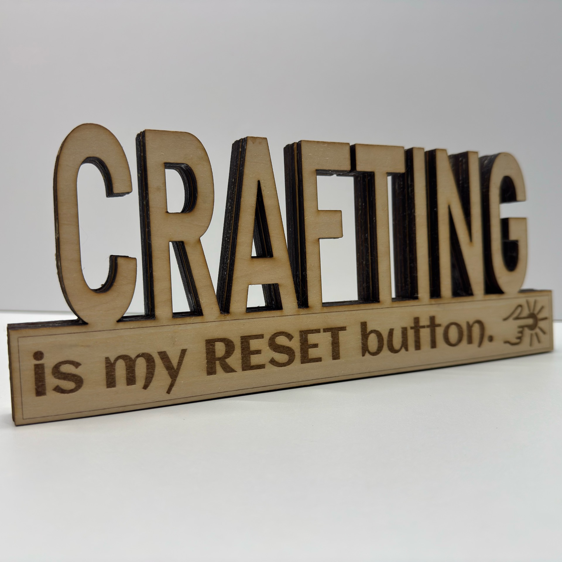

MACHINE SETTINGS:
A - Engraving the rectangle and the design.
Engraving Mode: Flat
Operation Style: Engrave
Mode Style: Line; Fill
Material: 3mm basswood
Power: 85%
Speed: 7500 mm/min
Passes: 1
Time: 20 seconds; 7 minutes and 22 seconds

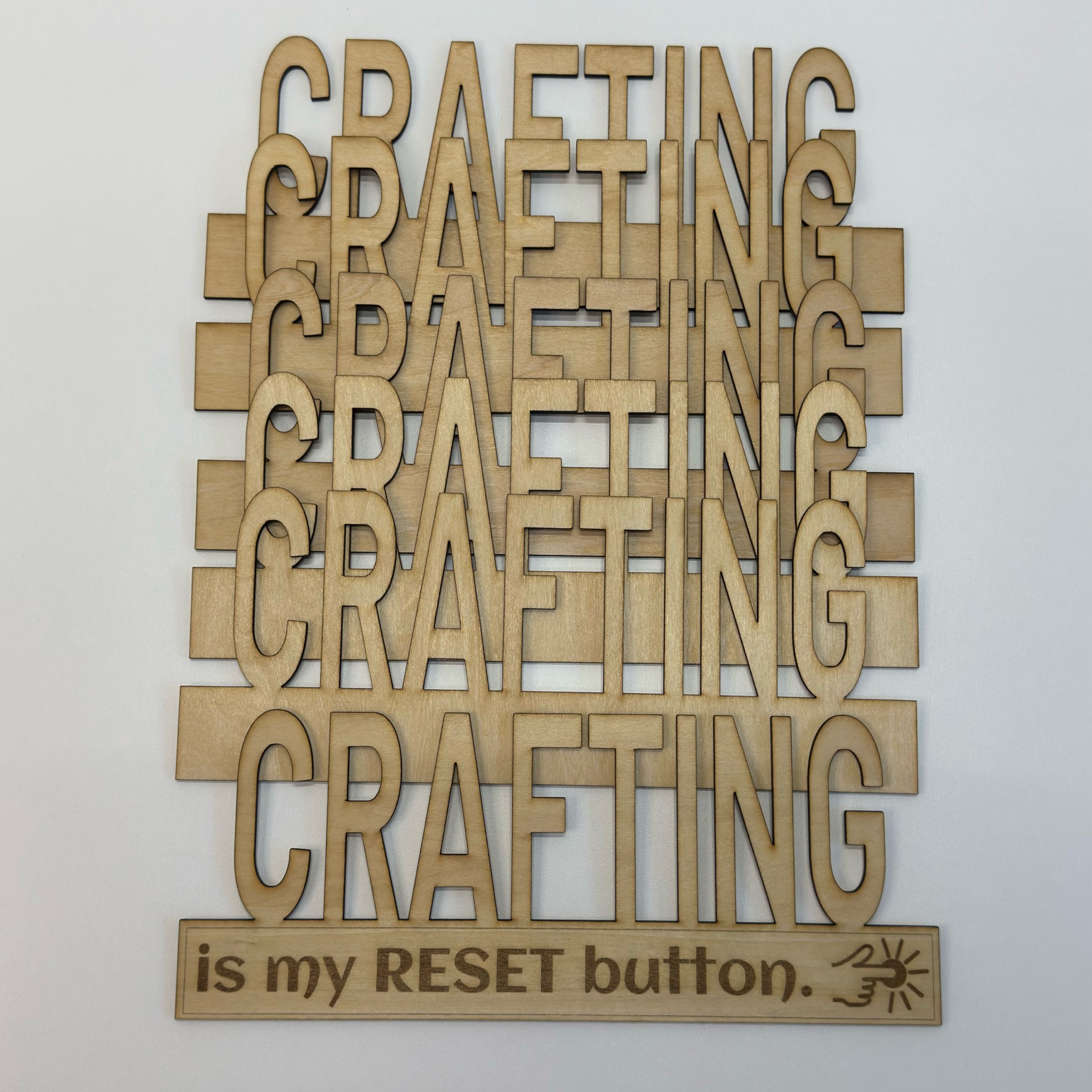

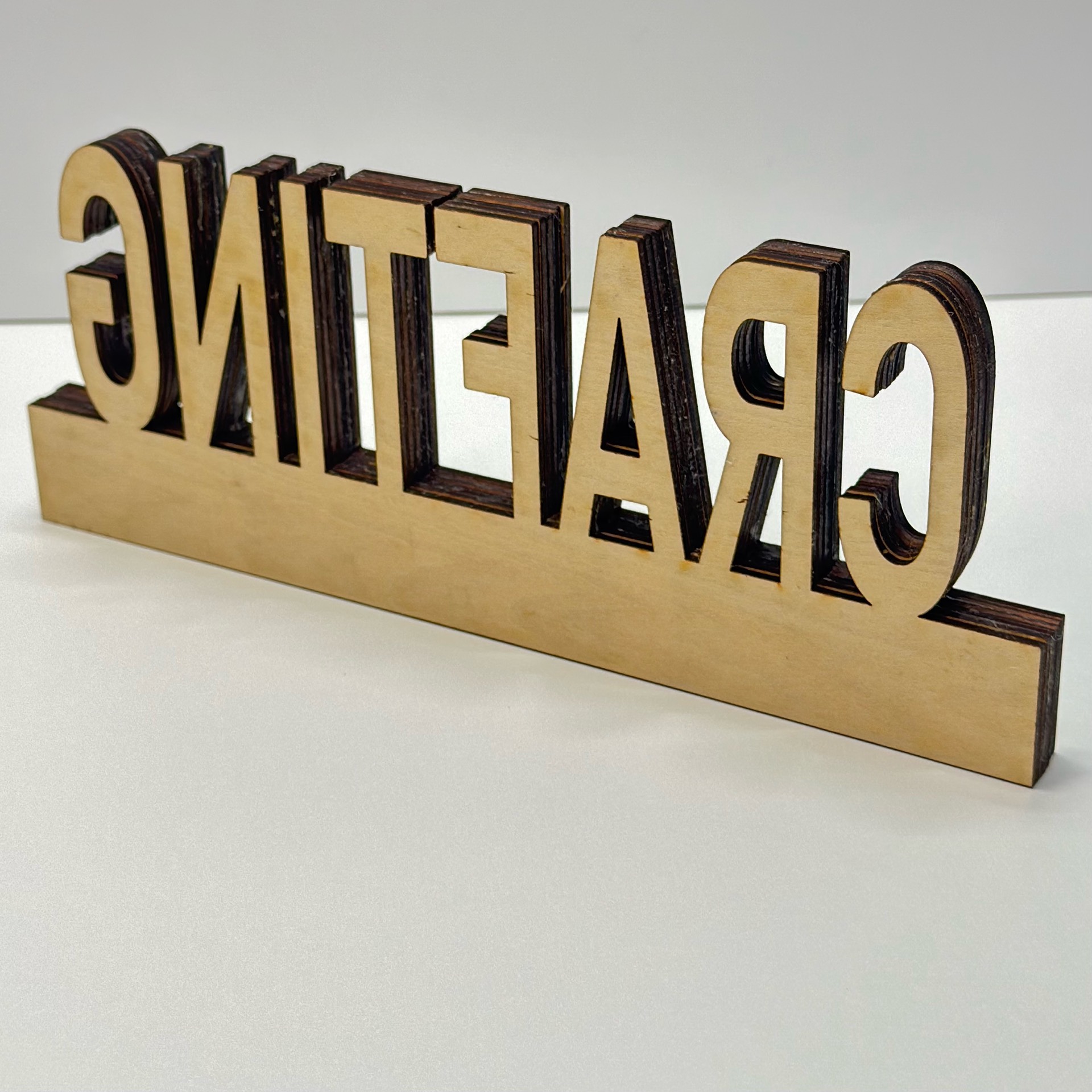

B - Cutting the design (6 layers).
Operation Style: Cut
Mode Style: Line
Power: 100%
Speed: 230 mm/min
Passes: 1
Time: 1 hour and 5 minutes

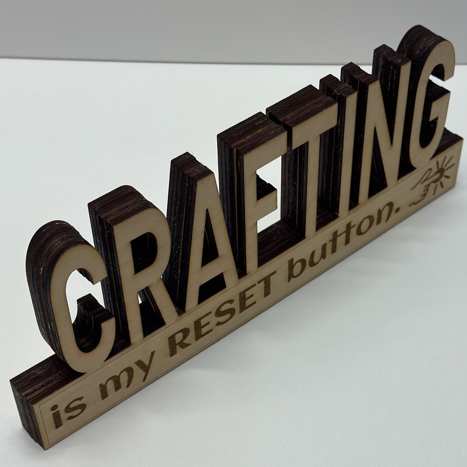

MATERIALS USED:
🩷3 pieces 12" x 12" 3mm basswood
🩷 Wood Glue
🩷 Paint Brush
🩷 Wood Clamps
🩷 Wet wipes
Finished Size: 10.28" x 4.13"
